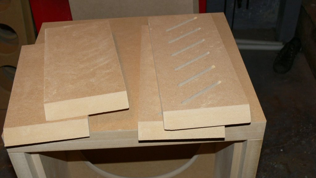

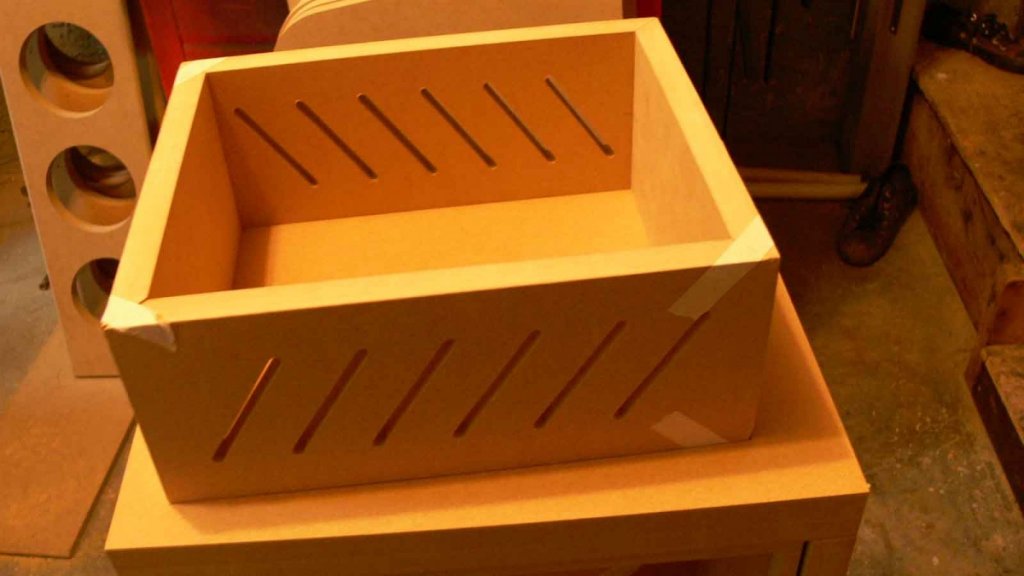

Amp boxes, 45'd corners and slots in sides.... will  get to biscuits this weekend
These are 5" deep.
They are $40/pr with sub flat packs, $50./pr if buying  them seperately to help cover boxes/packing materails.
jay

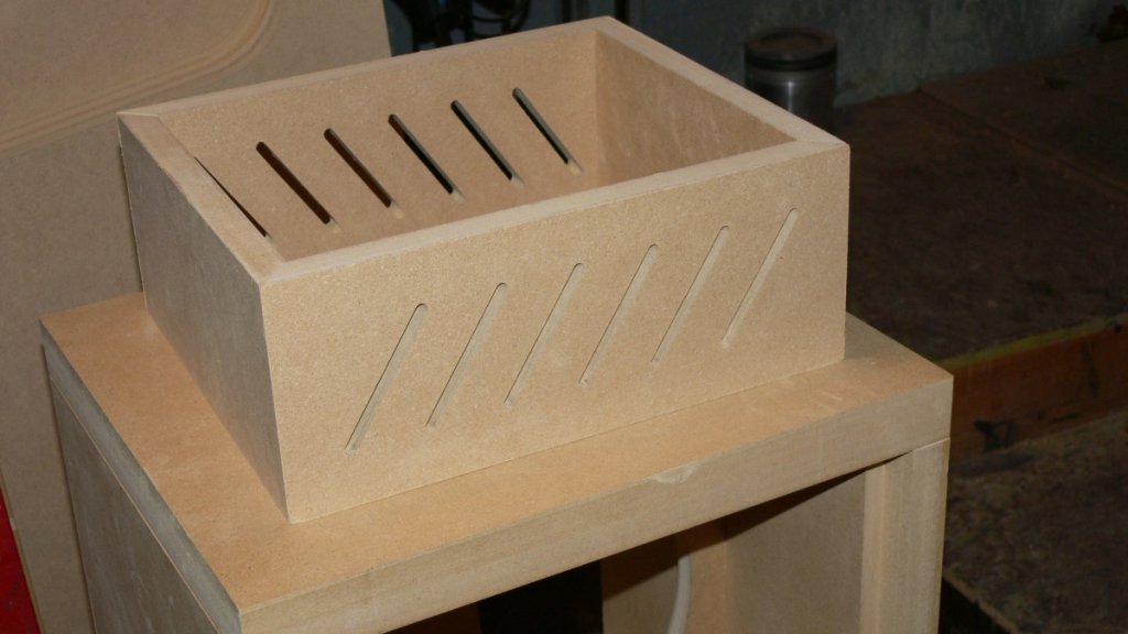

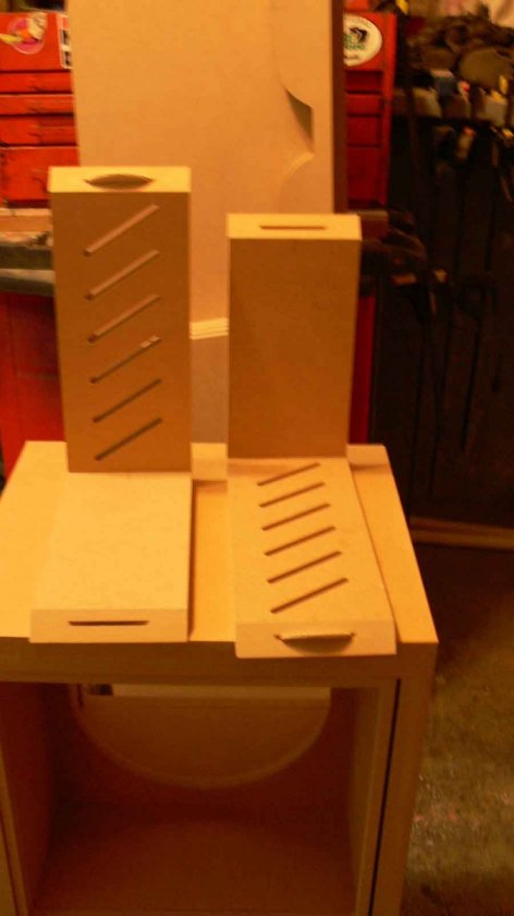

Biscuits are done
Easiest way to assemble is to use an end and a side  (plus 2 biscuits) to form an "L"
Add some glue (not shown) and push the two assemblies together
Use some tape or clamps to secure and let  set, voila
Lightly sand and finish  :thumb:
jay

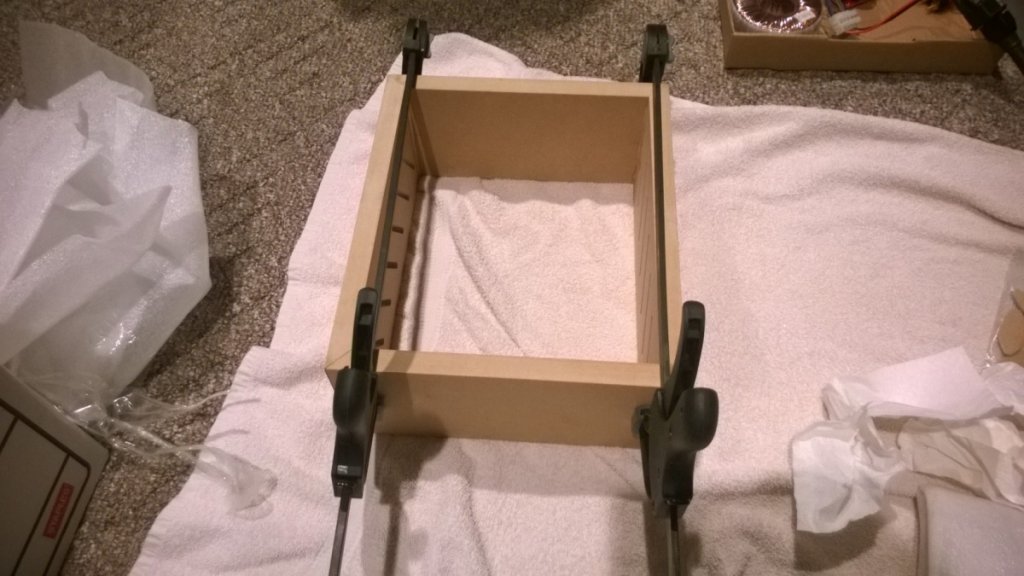

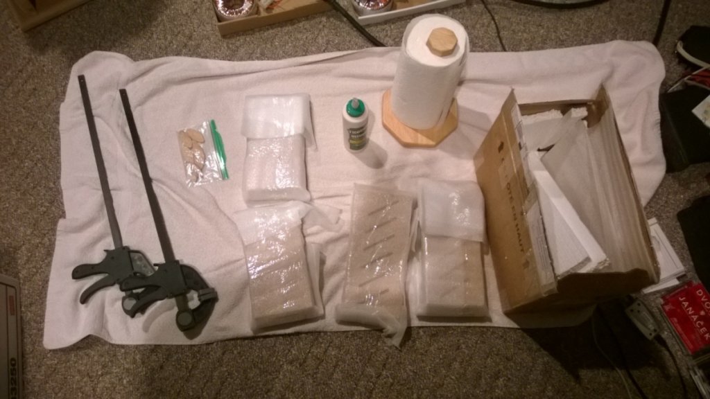

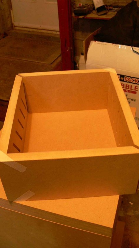

Pictures from the first amp cabinet build.
Opened the box and unpacked the flat packs.  Got the new batch of Titebond II glue and clamps from the earlier builds.
Next cabinet glued and clamped to dry.  After it dries will glue up the second one.

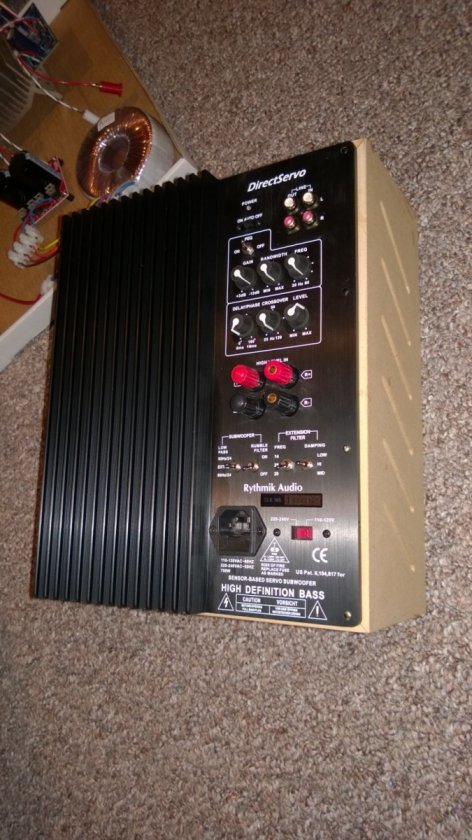

Test fitted the Rythmik Audio A370PEQ amp for the Super-V's in the flat pack boxes from Jay today.  Nice fit!
Will try my hand at DuraTex once it dries out after a few days of rain.
Never a doubt  right Rich  :lol:
Glad they work   for you  !!
jay

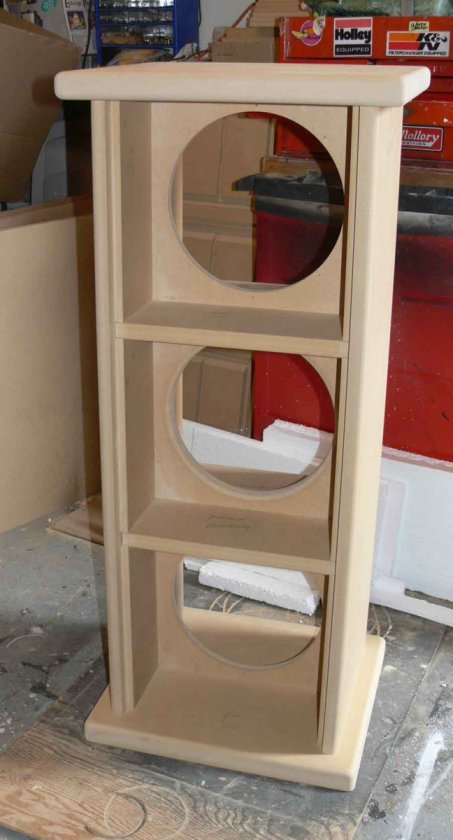

Here's a triple with the  overhaning tops,bases and a .5" roundover on all  outside edges but the very bottom
and with the grill  frame inseted
As mentioned earlier, if  you aren't into dealing with a seam, these larger tops/bases are  the way to go as they turn the seam into a transition leaving nothing to deal with  :thumb:
jay
