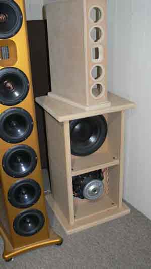

We sold our demo subs that I had been using in my room so I had to throw a  set of these modulars together and load them up with some drivers until I can  build  a  permanent pair for my room ( again  LOL).
I popped one of the   prototype wedgie cabinets up  on it  in these pics...... the  4 wiring pass through holes inthe  rearward  facing   baffle really   aid in keeping the  wires as short and neat as possible
This  was also the trial run for bolting on the bases  to make  adding an additional modula easy.  The bolts go down through the base and thread into  inserts installed in the bottom of the base.
jay

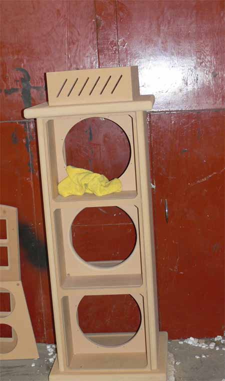

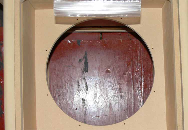

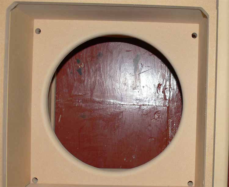

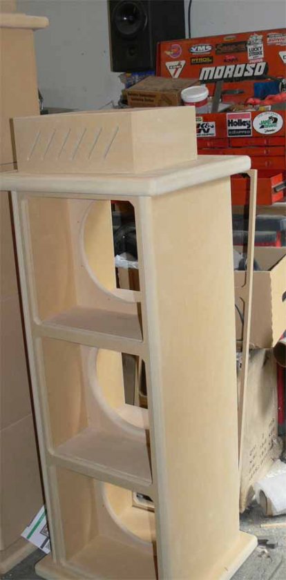

Finally getting  some material flowing again  :)
Another pair of triples  ready to go
New cabs are now using  1" Medex for bafles and braces.
driver mounting  screw holes pre-drilled
Roundovers on  rear side of  driver cutouts.  May have shown this before, but we are now  putting  4  wiring pass through holes in baffle for rearward facing  drivers. This allows  wires to run up both sides ( one side driver coil, one side servo coil) and  let's  you   go  out to the front at the bottom, run up to the terminals,  then cntinue up   and out the top.  Saves back and forth wiring and keeps  wiring as short as possible.
jay
