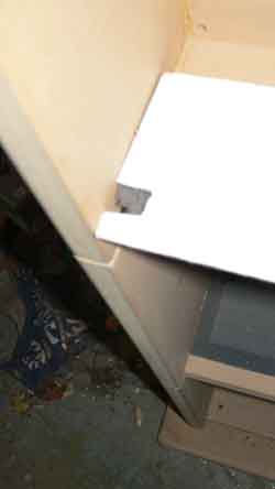

Re: OB H-Frame / A370PEQ / HX800 amp Box Flat Packs
« Reply #373 on: 20 Jan 2018, 10:11 pm »

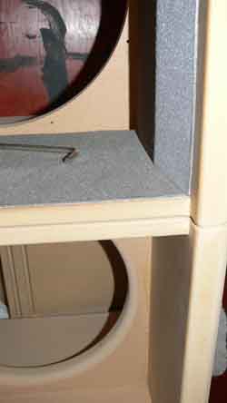

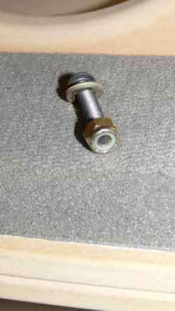

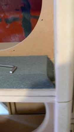

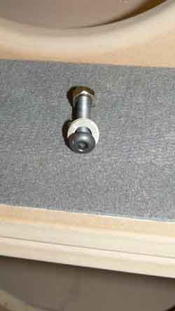

regarding the no-rez and the bolts / nuts that holod the modules in place.
The  center of each bolt hole is  19mm in from  the side panle and  27.5 mm in from the front or rear edge.  Whenther you do  your no rez with butt joints or  miter it, the  bolts will be hidden by the  no-rez on the side panel once it is installed.
You  can either drill a hole  in the   location or  you can  just notch  the hard damping layer  .  Try and leave the  foam above so it meets up properly withthe  foam on the said panel.  I  just snipped this out quickly with some side cutters for  pics  , could have been eater  LOL
Here it is flipped with  the bolts installed
And  after the  side panel no-rez is in place
Bolts are a nice  hex cap with nylon  locknuts
jay
« Reply #374 on: 21 Jan 2018, 12:21 am »
So the bolts are hidden behind the norez? So if you would like to break down the boxes would you have to remove the Norez or could the bolts be loosened and disconnected without having to replace the Norez?
« Reply #375 on: 21 Jan 2018, 06:56 pm »
Yeah, the bolts/nuts are hidden under the foam of the   no rez.   You'd be able to get them out if you wanted to  break them down, it'd  just be a matter of  compressing the OCF and getting an allen key in the bolt,   a socket onthe nut below.
jay

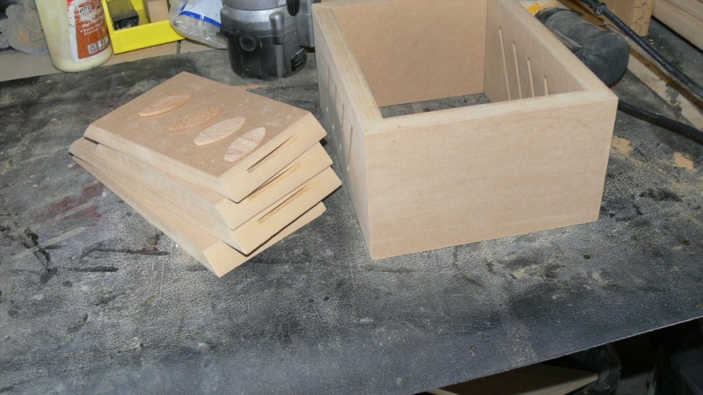

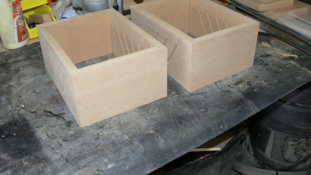

We've   done up some of the  same  amp boxes to fit the  HX300's   . These are  bsically the same design as the  A370/HX800 boxes but  sized accordingly.
Boxes   are vented,  45'd inthe corners,  and  earch corner has a single  #20 biscuit.  Easy to assemble.
Pricing is the same,  $70/pr or $60 / pr  with flat packs
I can  core a  1" hole inthe  end plate if you  want to mount a female  4-pole connector inthe  amp box
jay
