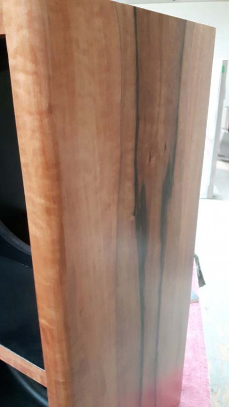

Jay,
They look really nice with the sealer. Should really be something with the lacquer.
Mike
Agreed !  I knew once  there was  "something" on them , they'd pop, but  when we were standing there watching the guy spraying the sealer,   I was pretty shocked at just how much  they changed.  Can't wait to see them all finnished up,  hoping I can get the  client to   post some pics when they are set up in his room  :)
I wouldn't hesitate to use this Indian Apple Wood (Tineo) veneer again, beautiful stuff
jay

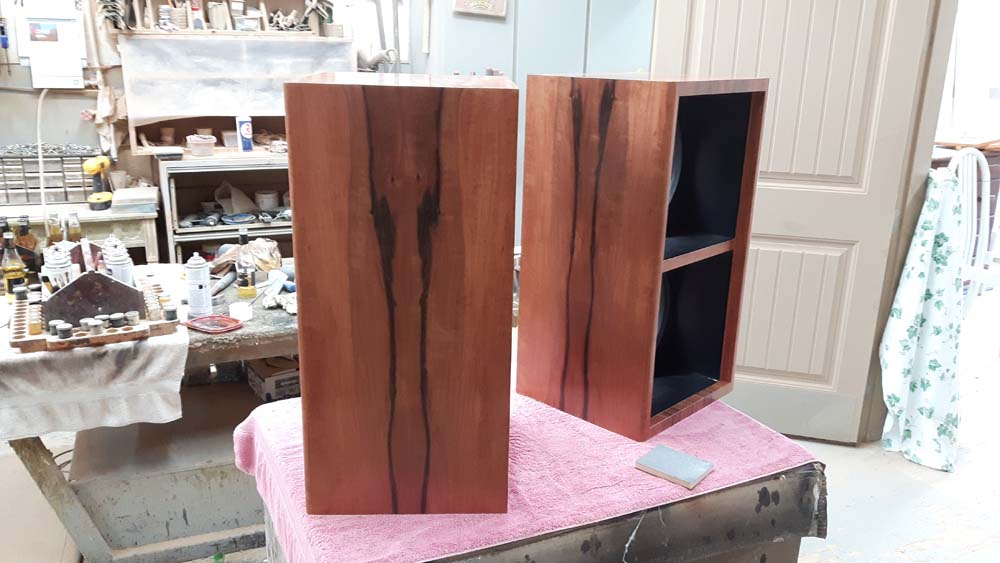

« Reply #203 on: 23 Oct 2016, 03:12 am »

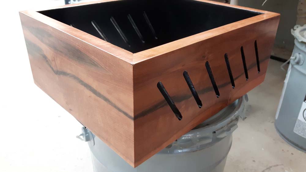

Here we go, 6 coats of  satin lacquer  and  they really do pop
Just need to glue the magnets in the grill frames,  pack them  up ,    and ship them off
jay

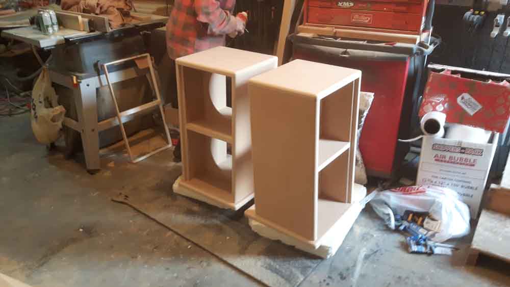

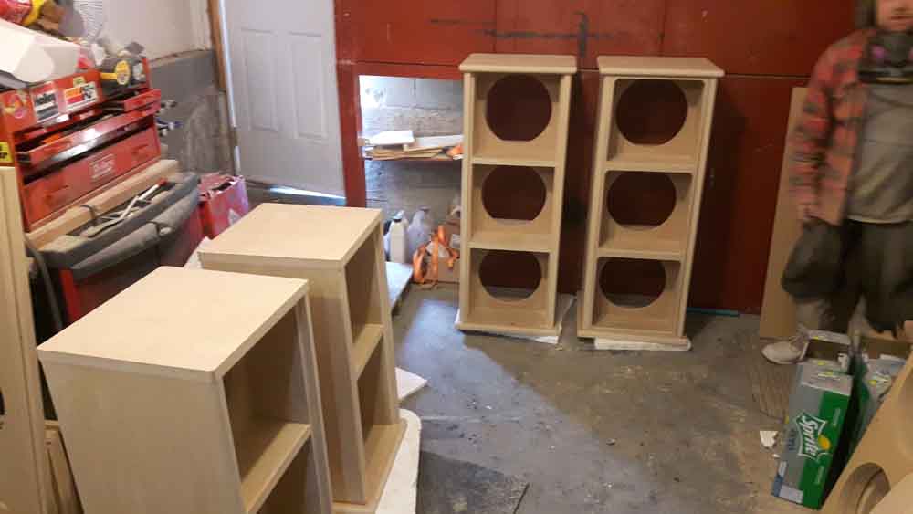

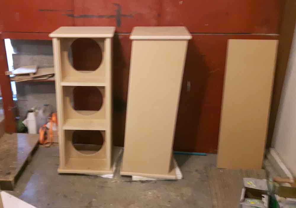

A couple new projects on the go....
A set of  sloped triples with all woofers facing forward.  He  went with a small  over hang on the tops to eliminate the need to deal with a seam.  These are going out as flat packs
We also added  sloped duals   to our  designs.   Glued this pair up the other day for a customer,.  Flush tops, bot woofers facing forward, , front recessed grills,  .5"  roundovers all the way around.  finish will be  piano black
jay

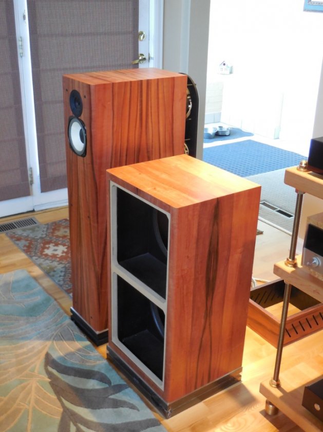

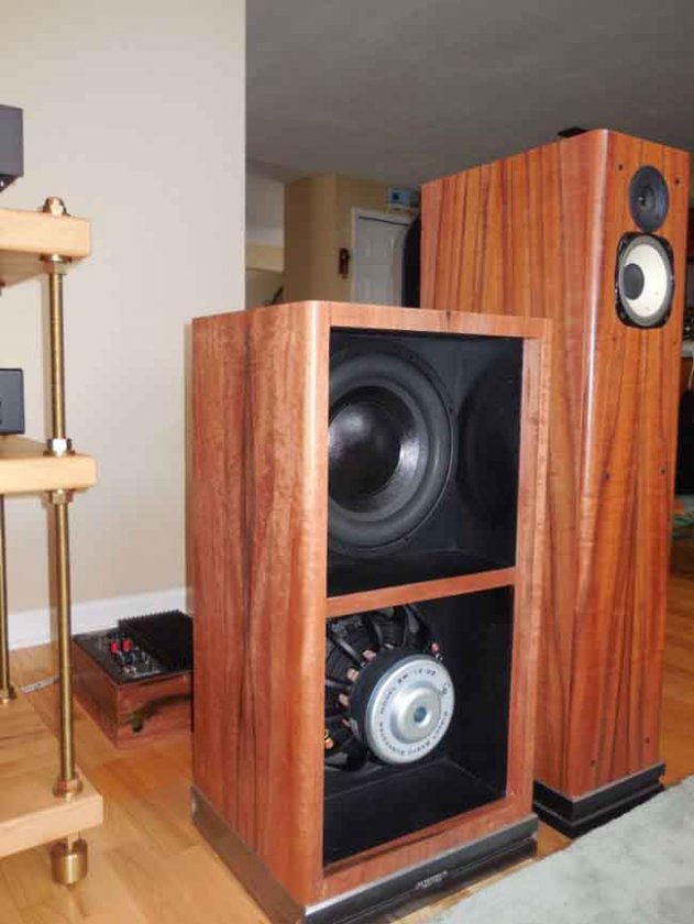

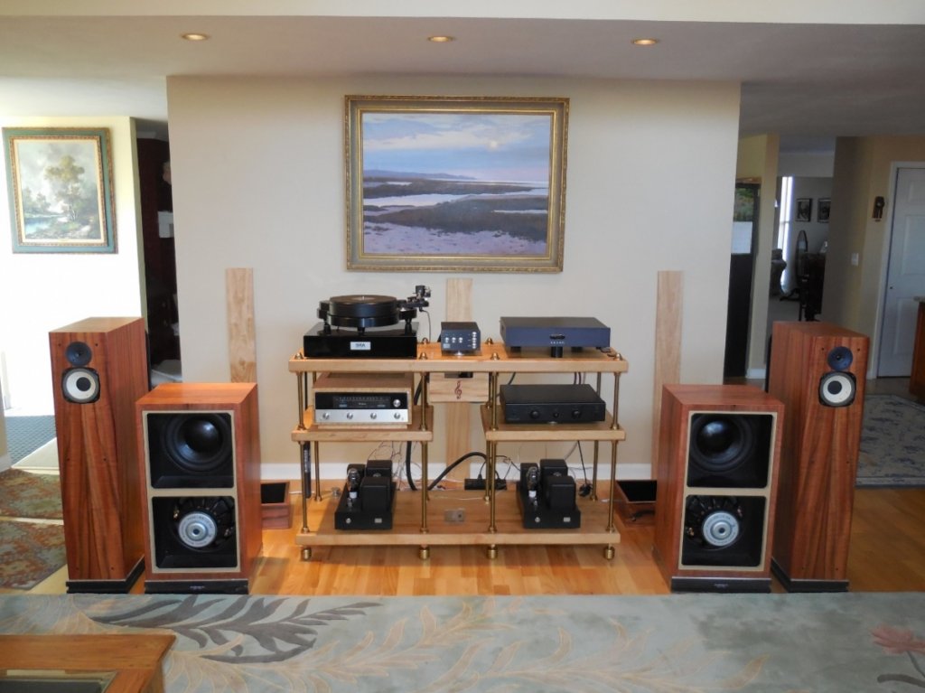

Update on teh India Applewood subs....
So  back in late Oct  when we went to box up the Indaia Applewood subs pictured above, we noticed some issues with the veneer, we just couldn't sen them as we weren't happy with  the job that was done:(
Decided to call the client and explain the unfortunate situation Disappoiting but he understood and was actually appreciative we didn't ship  them and have  "make the call"
We buuilt out a 2nd pair of cabinets and  this time we did the veneer in house, another lesson learned the hard way
The 2nd pair arrived  at their new home  just before Xmas (Mery Christmas Ken:xmas: ) and the new owner is getting them  ready for bass duty.  He sent me a few pics today with the drivers installed  and sitting in place with the speakers we  were trying to match
  :thumb:
-jay

ebag4
Re: OB H-Frame Flat Packs
« Reply #211 on: 1 Jan 2017, 01:36 am »
Those look fantastic Jay! Is the inset for the grill frame painted or veneered?  I am deciding that right now, the plan at the moment is veneer.
Best,
Ed
Danny Richie
« Reply #212 on: 1 Jan 2017, 01:38 am »
Nice job Jay.
« Reply #213 on: 1 Jan 2017, 02:03 am »
Thanks guys !.
Ed,  the insets are all veneer too,  was a bit tedious but I think  well worth the effort.  I'll try and get the  owner to get a shot or two without the grill frames at some point.
jay

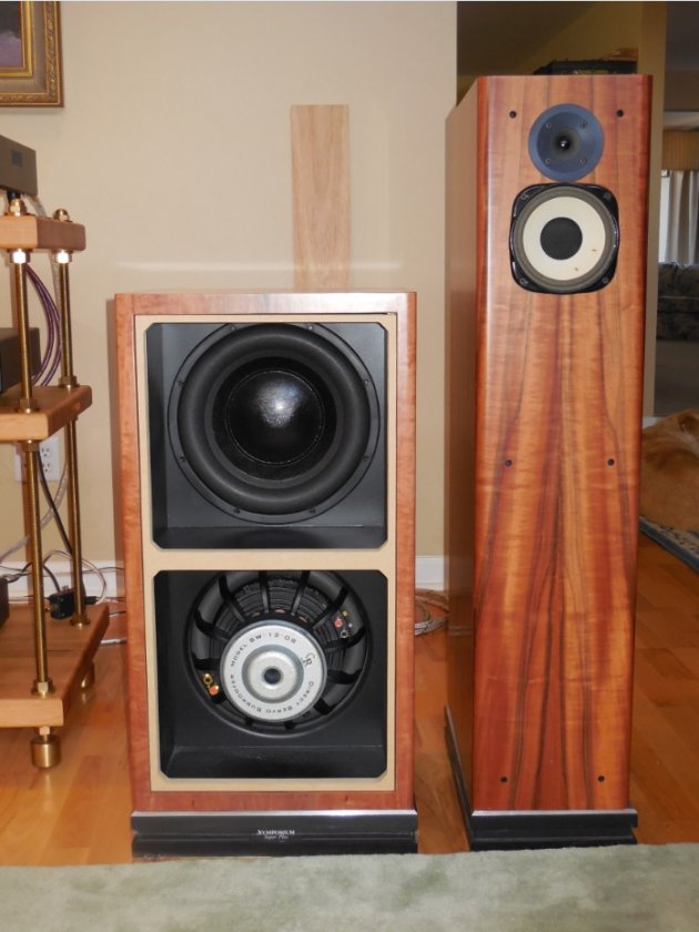

The veneer on the subs matches that on the owner's speakers really well Jay. Great job! I have been recommending the OB/Dipole sub regularly and frequently in the Audiogon Forum, which is where this owner learned of them. He then contacted me, and I referred him to Danny (who closed the deal and made the sale), and then to you. Hope he likes the sub as much as I predicted he would! It appears he has both his speakers and the subs sitting on Symposium Acoustics isolation platforms. A serious audiophile!

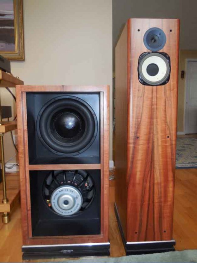

The customer saw the posts above and forwrded a couple pics withou the grill frames
jay

« Reply #217 on: 3 Jan 2017, 09:26 pm »
First class job Jay, those look great, and yes, the insets are just a bit tedious :duh: :lol:.
Will No-Rez be added?
Best,
Ed
« Reply #218 on: 3 Jan 2017, 11:08 pm »
Best,
Ed
Yeah, tedious and time consuming but, worth  it in the end, was glad to see you doing yours too  :thumb:
Yup, he's got the no res, he'll add it last.
jay

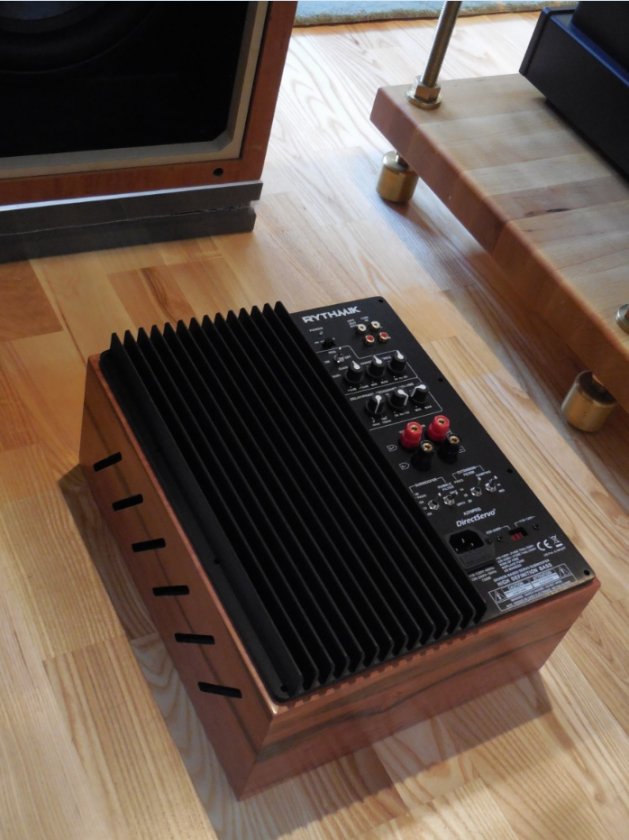

It would be great if Rythmik plate amplifiers came in L shape, bent right after the cooling fins.
This way one would be able to put the huge transformer and those caps in the cavity (bottom of the H frame would need to be some 4" tall), the cooling fins would be sticking out a bit, but all the controls would be in that case on the bottom back of the frame and everything in a single box.
Current height of the plate is 12-7/16", this would perfectly match both W and H frames with 12" drivers.
