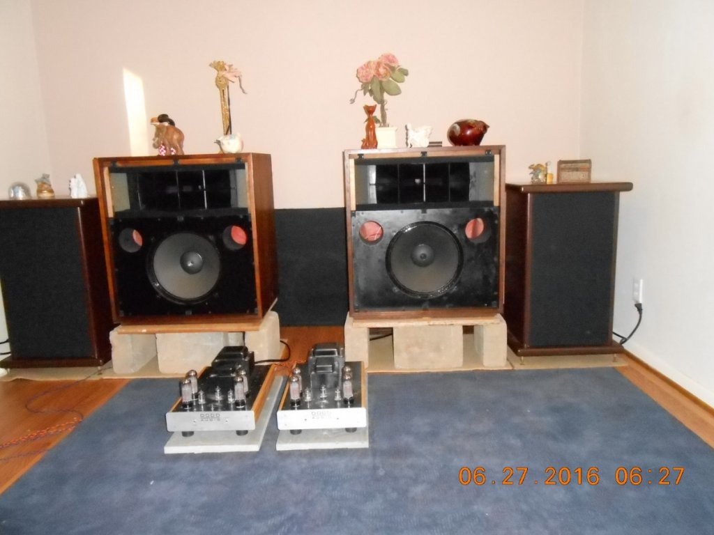

Just wanted to post a picture of my system with a pair of Jay's flat pack dual OB subs. I have an old (1966) set of Altec Valencias in which Danny helped me upgrade the x-overs. I am running first generation Dodd Audio 120 monos and a Dodd mid pre. They sound great with the new subs. Thanks To Jay and Danny for all the help.
Fliv
Danny Richie
Re: OB H-Frame Flat Packs
« Reply #139 on: 30 Jun 2016, 05:57 pm »
Nice amps Fliv.
You might want to try pulling those woofers further out into the room. You should get a lot better results that way. Some room treatment will go a long way too.
Thanks for posting the pic.
