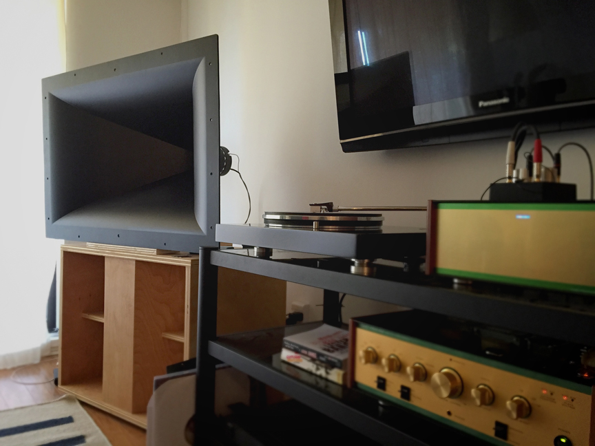

lokie and I are on similar paths. I live without low bass in favour of my horns, tubes, and analog set up. The last thing I want to do is put DSP in the chain. I am ok with a little processing on the lowest octaves. The mid-bass horns are decent to about 90Hz, after that they are simply a 15" woofer in a small sealed box. I don't have the space for 8' folded bass horns.
I know that Volti Audio has a large sub they sell with the'r Klipsch style horns. To me, it just looks like huge displacement to 'fill in' bass. I would hope for something a little 'faster' to bring to my room.
My horns:
