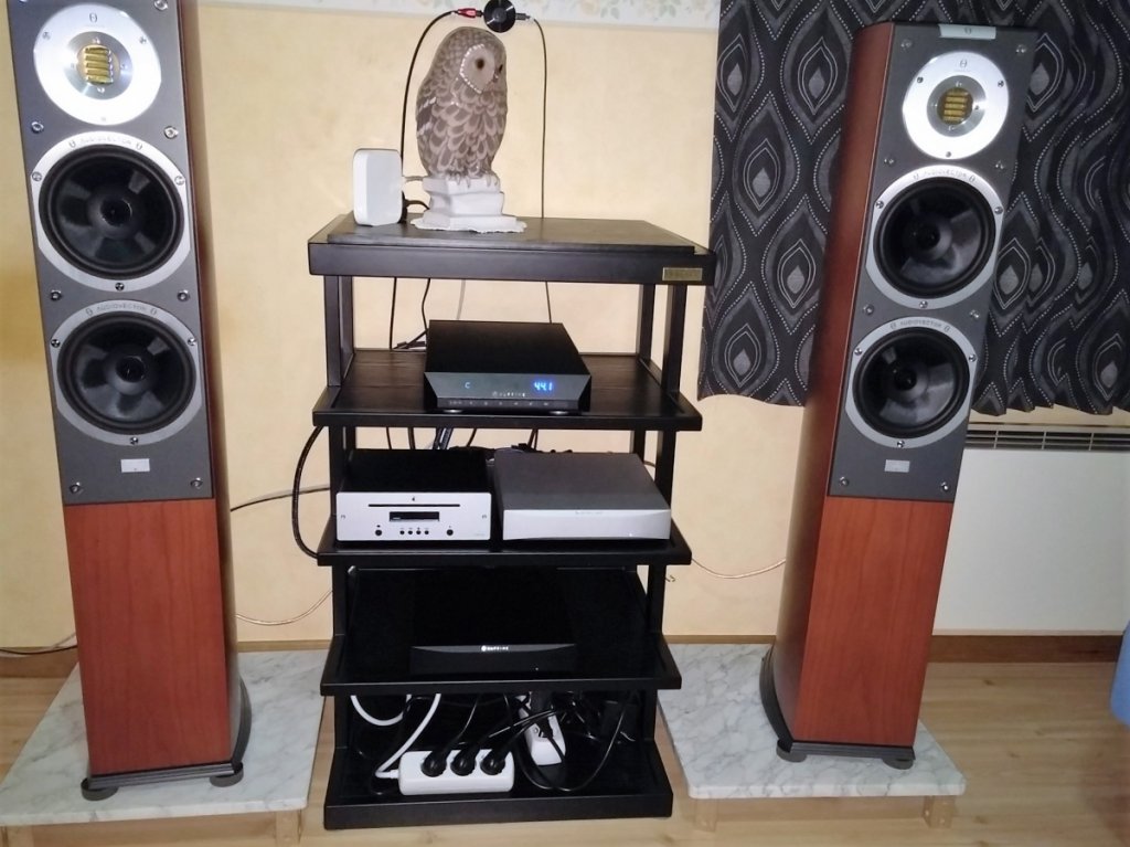

Kenwood KD-64F + HPA-9 + ST-10 + JBL 4312E on second floor.
Panasonic TV + IDA-8 + Tannoy Mercury V1i in living room.
PC + DAC-10 + 2 x STA-9 + Pro-Ject CD-player + Audiovector SR3 AA in my mancave.

« Reply #55 on: 23 Apr 2016, 10:04 pm »
Silver for right and black for left  :D
