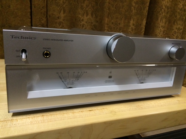

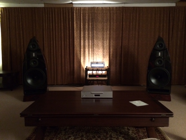

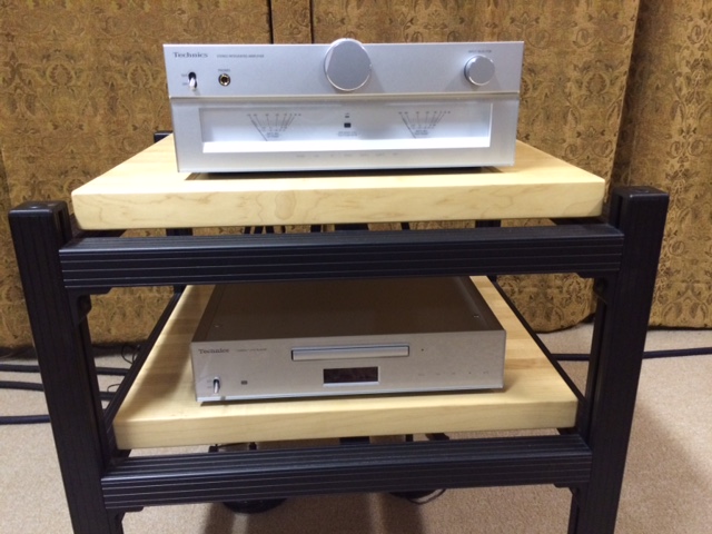

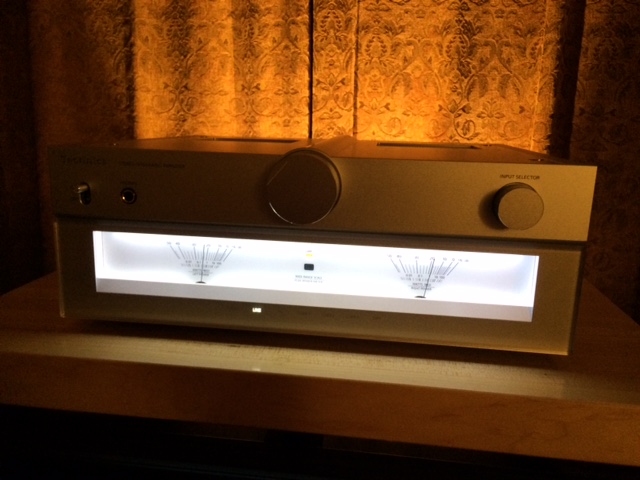

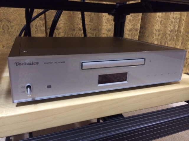

so...i had the new Technics int amp and CD player in my system for about a week...45W was enough to get the woofers going on my Nimbus...lots of detail...but...the celoos, the violins, the pianos sounded so nasal and 'digital' like...weird...so i put back my Densen/Jolida?Aaron set-up and everything is fine...i thought that for sure the Technics class-D int amp is the culprit...
Took both Technics units to 2 other audiophiles...one that has Focal Utopia speakers, and one that has Mission Pilastro speakers...guess what? No nasal sound, no screechy-metallic sound...nothing of the nastiness i heard in my system...i can't believe the cables had such a big impact...the sound was great!! not to the level of their other components, but the Technics hold its own against gear costing 20-30x more...
I'm still puzzled why that sound with my Nimbus...i know how well the Nimbus  sound with my current gear...but why the nasal, metallic sound??...
one of my buddies ended up buying the Technics units from me, so no financial loss...i wanted the int amp to sound good cause i like the looks....oh well...live and learn

Not sure what to tell you could be the cause of what you heard.   We've had numerous different amps driving the Nimbus and never encountered anything like you described.
Maybe the other speakers aren't resolving enough to show the shortcomings of the Technics?   :wink:

The amp might be vulnerable to resonances, that hit just right with the Nimbus. I'd have to see a schematic to say for sure. A zobel may fix it, and that's easy to try.

The impedance of the Nimbus does peak at 17.5 ohm at about 2KHz, and 12 Ohm at 250Hz.  The lowest impedance is 6.3 Ohm at 650Hz.
If the amp can't handle a swing of 11 Ohm without losing control, well, that's a problem.
A conjugate filter would be easy enough to build to smooth the impedance to a flat 6 Ohm.

The swing of ohm's isn't necessarily the problem.
The amp if oscillating to a resonance will sink more current, and combined with a swing in ohm, may drive the output devices into clipping.
On typical amplifiers I'd simply recommend the Zobel, like a 47R and .01uF cap in series. But now that I think about it the problem is the output of this unit may or may not need it. It depends, if it uses transistors or gainclones for the output it'd be great to try. But if it doesn't, and the output is coming directly off of inductors and tiny film caps bypassing to ground, the inductors probably need dampened.
You're welcome to contact me about having a look at the amplifier to see if it's easy to fix.

oh, i'm not saying this is a problem with the Nimbus...btw, my Nimbus is the 'Black' version so no ceramic drivers...
it was just puzzling to hear that nasal screetchy sound...very detailed, but very 'cold'...i heard the amp at the show driving the $17k new Technics speakers, and it sounded great! it did a very good job (not spectacular - heck it's a $1600 amp) with the Mission and with the Jm Labs...I guess it wasn't a good match with the Vapor...I returned it...I'm back to my trusted Aaron Millenium amp. :)

cute little things...too bad they don't match with my Nimbus...

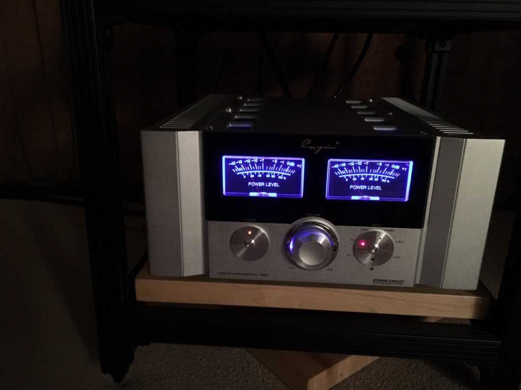

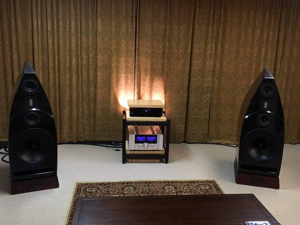

well, i finally found the perfect match for my Nimbus...let me tell you something...if anyone finds an used Cayin H-80A, buy it!!! I paid $850 for this unit and it's absolutely AMAZING!!!!!!!!! I've never heard my Nimbus sound like this!!! I finally got the tight bass that I was chasing without losing the soundstage, and instrument separation!
Ryan, when are you coming to visit? I think you'll be surprised how well the speakers sound with this integrated amp!

Told ya the speakers were good :thumb:

Wow, that Cayin looks like a beast ... and sounds like you stole it for that price!  Congrats!

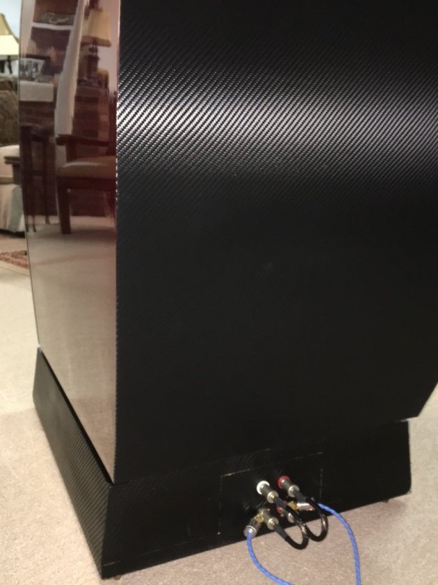

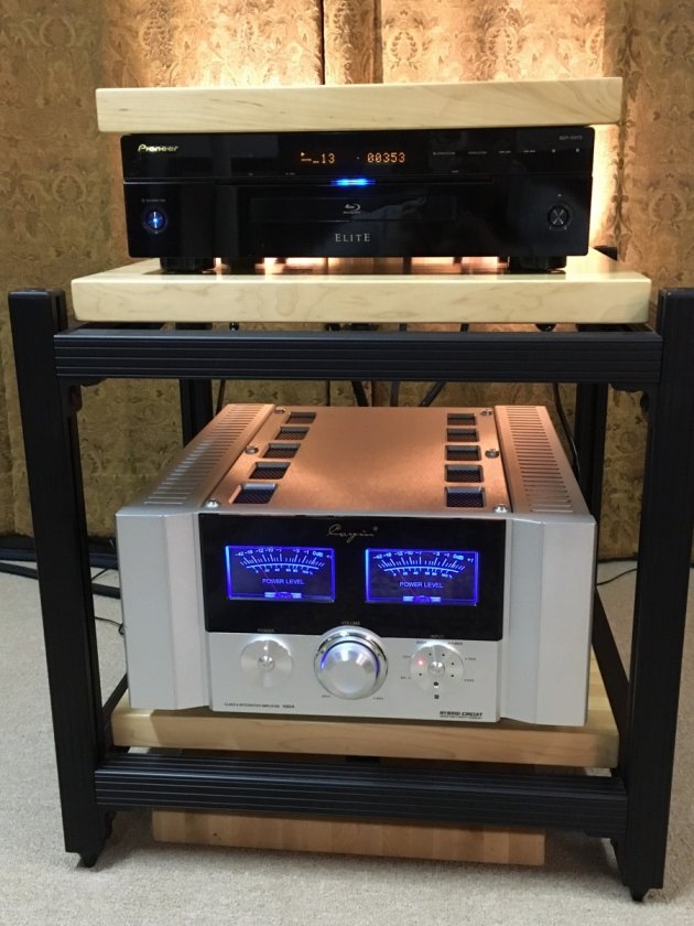

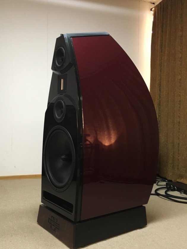

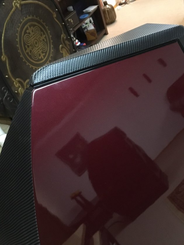

here are some more pics of my system..Saturday night, being snowed in, I decided to replace the Densen 400 XS CD player with a Pioneer Elite blu ray player that I have in the pile of electronics hanging around...well, i was very surprised by the audio performance of the Pioneer...i guess those Wolfson DAC's are quite good...great pace, nice bass, and great definition between the instruments...maybe a tad narrower soundstage, but a great sounding player...
i tried to show the custom carbon fiber finish on the back and the top of my Nimbus...to match the pedestal that houses the crossover...

Those Nimbus look Sa-WEEEET! Maybe the "Carbon Fiber Edition" should be an official option?
