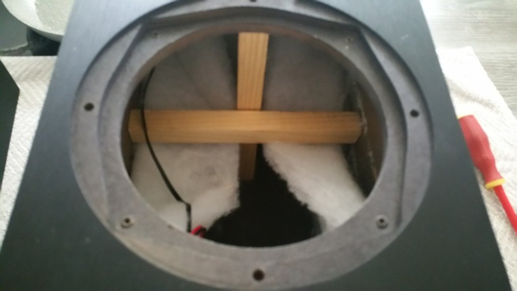

Hallo
I just did internal bracing on my Elac B6 becouse the problem with resonances. I think that the resonances are gone now.
