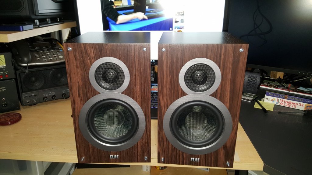

« Reply #144 on: 20 Feb 2017, 11:29 pm »
I have the B6's set up, I know they'll need some time running but initial impressions are the X-LS's have better or make that snappier bottom end but the treble is a tad better in the B6's. As for looks, the X-LS Rosewoods win hands down but then I wasn't buying the Elac's for their looks, hopefully the sound improves over time.

« Reply #145 on: 20 Feb 2017, 11:40 pm »
Another note, paired up with my MFW-15 they sound fantastic, the wife isn't happy so turning the sub off to run the B6's for a few hours.
