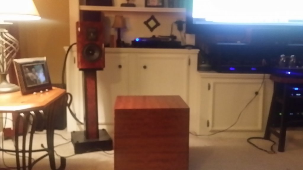

Stlrman sold me a really nice servo sub he had built by a guy in Pittsburgh.  Sounds great and blends very well with my Breeze. The waterfall Bubinga looks really nice as well.
UPS tried to rip the amp out of it in shipping but I screwed it back in and everything works fine.
