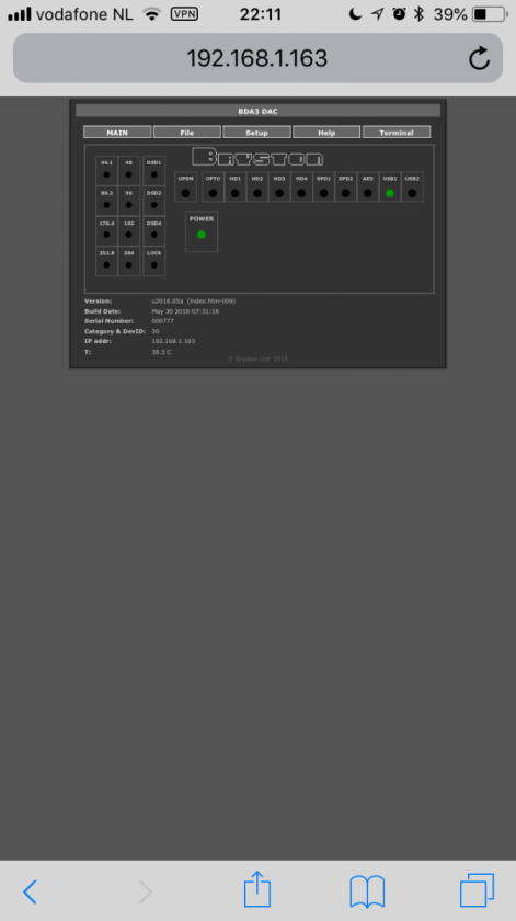

What just happened to my BDA3?
Turned it on and after some seconds all lights come on, no sound.

Xinon
Re: BDA-3 DAC
« Reply #954 on: 31 May 2018, 10:37 am »
Oki, so I found out what happened to my BDA3.
A thunderstorm had me pull out all the main plugs from my stereo.
When I plugged everything in again, alle lights(as shown in picture) turned on and it was not responding.
When I came home from work everything was normal again, I thought.
But there was an added bonus.
I tried several times some month ago to upgrade firmware on BDA-3 without any luck.
Well, plugging it in again started the upgrade, and it now runs the newest firmware  :thumb:
Its not easy getting old :lol:

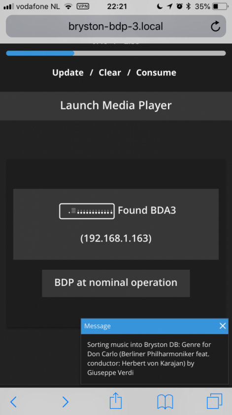

Marius
Re: BDA-3 DAC
« Reply #959 on: 31 May 2018, 08:18 pm »
I know the Denon, Pioneer and some OPPO players are fine.
james
Ok cool on my list;-)
Let me ask please : trying the online interface (need to switch hdmi sources my br2 won’t select), I’m stuck with this rather unreadable small interface on iPhone . Switching landscape is somewhat better but still not very  adequate. Should at least be responsive to the device at hand, no pun intended.
Is a better interface , like the Bdp for example in the works? You know, the other half factor is at stake...
More of a tech question: I tried Bryston-bda-3.local but only the ip-address is accepted ?
Thinking of a possible way out, wouldn’t it be very nice if instead of only discovering the bda3 in the Bdp interface, and providing a link, the set of inputs were displayed right away?
Cheers
Marius
