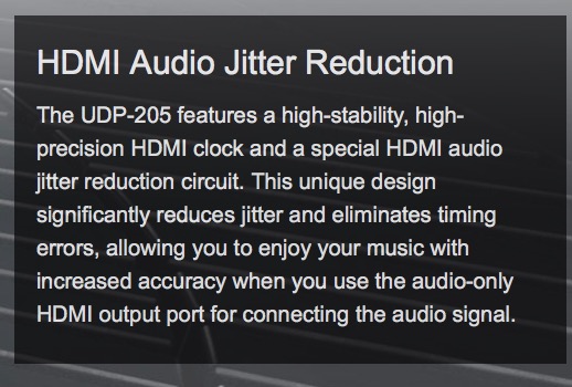

HI James,
please have a look, could you post your advice to these questions?
Marius
HI James,
Is there any chance you will produce a BDA3+ which will have the lost SPDIF and Toslink back? Adding the 4 HDMI ports is wonderful , but losing the important SPDIF/Toslink is rather a crucial letdown to be honest.
We might be able to replace the Toslink the HDMI connection but as you yourself have always stated, the HDMI is possibly prone to serious jitter, thus the SPDIF inputs were always preferred. A BDA3 with these inputs reinstated would be a no-brainer.
Other question about HDMI jitter: Oppo state they have solved this by means of a dedicated clock/circuit http://www.oppodigital.com/blu-ray-udp-205/
Is the BDA3 also immunized for this HDMI jitter in a comparable, maybe even better way?
Marius

« Reply #856 on: 18 Aug 2017, 03:23 pm »
Hi Marius,
Fron Engineering:
“We also use a high-stability, high precision HDMI clock and a special HDMI audio jitter reduction circuit. “
That statement has very little meaning.
HDMI inherently has pretty high jitter, we reduce it but it is still higher than SPDIF or USB inputs.
Marius
Re: BDA-3 DAC
« Reply #857 on: 18 Aug 2017, 07:09 pm »
Thanks James,
honest and straightforward, that's why i love Bryston  :thumb:
Otoh, the statement from engineering is just about the same as Oppo's ... A dedicated HDMI clock/circuit is used. I gather these to be just as up to their task as can be. Is there any chance engineering could elaborate on that dedicated circuit a bit more? Would it be comparable to the synchronous/asynchronous implementation of USB connections?
Your remark about the HDMI jitter being inherently higher than SPDIF and usb was the reason I was rather disappointed about losing these extra inputs on the BDA3 in the first place, and kept me from upgrading my BDA1 up to now in the second. Hence my other question if Bryston would be considering a BDA3+ with these lost inputs reinstated? Any such considerations being made James?
Also, would i be right in ordering digital connections from a jitter perspective like so: HDMI, optical, Spdif, USB? left most to right least? Or would Optical and HDMI be rather comparable?
Thanks again,
Marius
Hi Marius,
Fron Engineering:

I have been interested in the 205 for the same reason to see if it would be better than the 105-in this hobby you always look for better and it's easy to be seduced by the notion of better.
However as I recall from memory possibly the area that struck me as most improved on the BDA-3 was actually SACD through HDMI. However even if that is not 100% correct there is no aspect of swapping inputs (and I do a fair bit) that would indicate the existing jitter is in any way noticeable. Though that's not to say you wouldn't hear a difference between the 105 and the 205. I still await the first person to have tried the combo.
