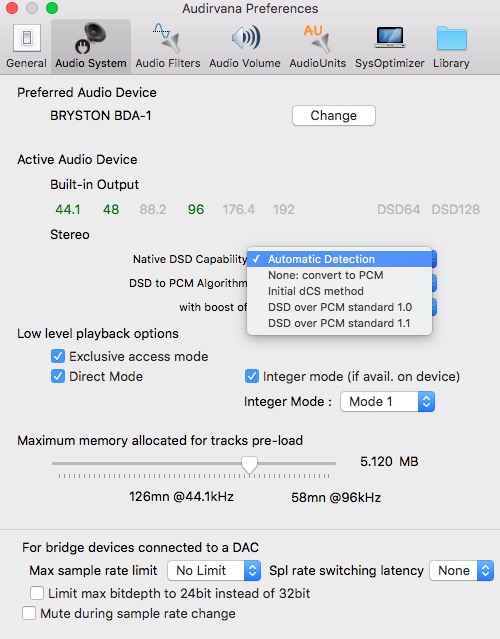

Tried it with the BDP-2 and No the BDA 3 only decodes DSD on the USB input.  I was told this is the only way to do it legally?  I will try JRiver and Audiorvana as well.

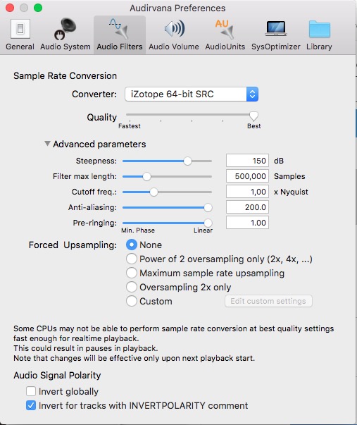

What about the Audirvana Plus Izotope converter? http://audirvana.com
has all the options:
seems best in class.... http://src.infinitewave.ca
(even has a promising remote app https://itunes.apple.com/app/a+-remote/id1008281758)
