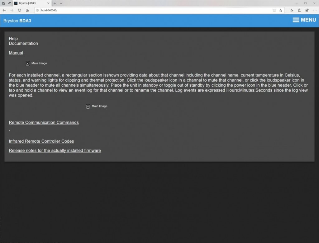

James, another note about the new firmware: when selecting Help from the Menu options, you get the screen below.  It appears as if it's incomplete, as there are placeholders for images that don't load:
Gerald

By keeping the inputs button pressed for a while on the web interface, you can edit their name. Like me, you might have inadvertently edit them to random characters.
You can do it again and edit the names back to what they were.
