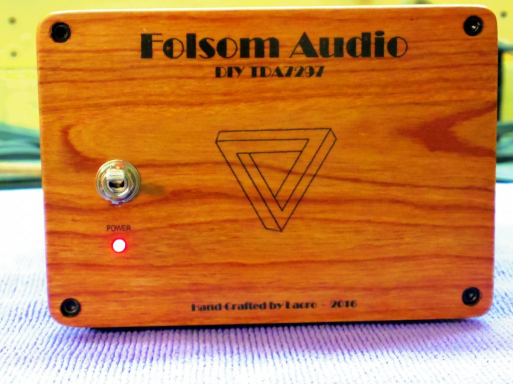

lacro
  • Posts: 602
Re: Folsom's great little 7297 Chip Amp
« Reply #968 on: 29 Oct 2017, 02:47 pm »
Vinyl decals are easy!  and much cheaper than mailing your frontplate to get cnc routed or laser etched hehe
Yes I realize now it's slightly crooked.  but hey that is part of the charm of diy or custom builds :P
I'm telling people that it's not crooked it's a dutch angle and my tribute to lars von trier ;)
got it from this vinyl service, very low prices
https://www.facebook.com/ambervinylallthethings
Nice! I will have to save the link for future builds. I made my own decals on my first Folsom amp build.
