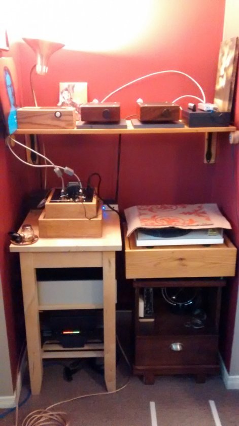

 Looks like you were able to stuff a bunch of  parts into that smallish chassis. interesting how you did the top :thumb: Curious what the single gang electrical box is for?
absolutk
  • Posts: 34
Re: Folsom's great little 7297 Chip Amp
« Reply #941 on: 10 Oct 2017, 04:30 pm »
Yeah, the top is just a piece of maple plywood that I had stained a few years ago, sitting on top! The electrical box was intended to include an outlet so I could easily mess around with various sources (The Raspberry Pi and the isolator HAT both need 5v, for example). I didn't do it because then the components would be too tall to put a cover on top.

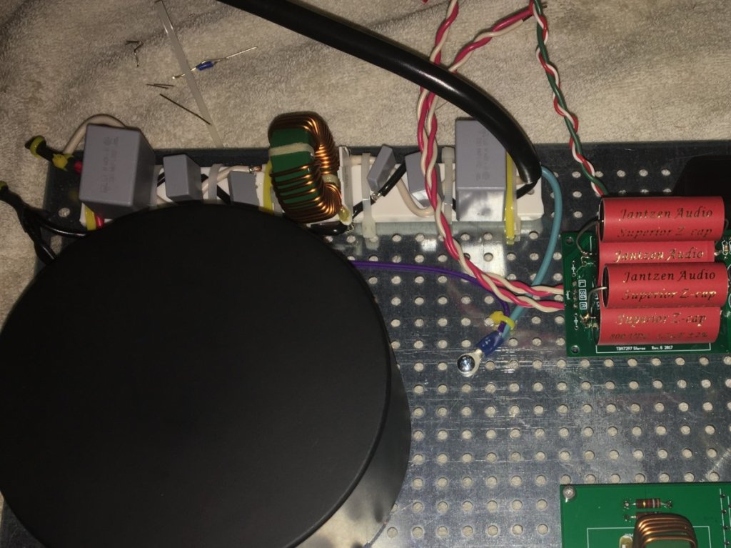

Hi Robert:
On my latest build, I wired a felix inside the case of the amp. For the resistor that bypasses each coil winding on the CMC, I used http://www.mouser.com/search/ProductDetail.aspx?r=588-23J1K8E. You can kind-of see the resistor, shiny brown at the base of the CMC. The other values you list (for the X caps and the Bourns CMC) are also what I used --> 1 uf .1 uf .01 uf CMC .01 uf .1 uf 1 uf. I put the felix in front of the transformer primaries. This picture is a little busy, but might give you an idea of what I did. I really love this amp! I should hook up my other build and compare, but haven't yet...

@ uncola, what is the varistor used for in your set up ?
pocomo
  • Posts: 36
« Reply #952 on: 20 Oct 2017, 02:18 pm »
@rtate - I think you are referring to the little standalone black disk in the photos?
My amp has the same thing - it's a PTC thermistor in the chassis ground connection.  It serves as a secondary fuse and an easily removable connection when debugging ground loops.
Folsom
« Reply #953 on: 20 Oct 2017, 05:04 pm »
I bet it's an NTC, because that would conduct very little until it needs to be wide open. Basically you can reduce ground noise with it, but when the juice starts to move it'll heat up and act like an open wire. That would be much safer than a PTC... which conducts all the time but would trigger like a fuse and leave you with a deadly hot chassis.

What is the little part between the thermistor and the AC connector/switch unit?
uncola
« Reply #956 on: 21 Oct 2017, 09:15 pm »
I believe that's just a chassis ground screw.  When I asked radu for more information about the thermistor he said it's commonly used in many nelson pass amps to break signal ground from earth ground.  This amp is insanely good.. I can't believe how cool it runs.. it's literally cold to the touch but sounds so powerful.  The soundstage is massive
