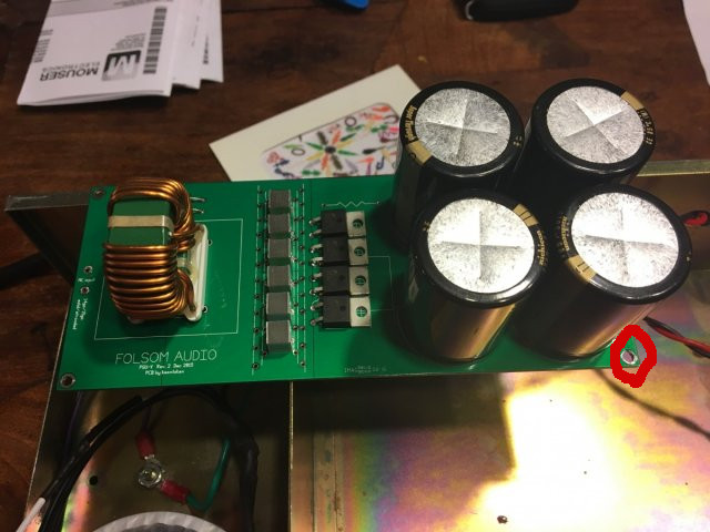

I didn't get that far.  I hope!  Transformer is working properly, and I definitely didn't drill anything out. Rectifiers are definitely shot, as they are no longer one way by testing with my dmm. The 7297 chip may have been contacting the heat sink when I first fired it up?  Would this fry the rectifiers?  I will order new rectifiers and install and see if I get a repeat performance. I did not install insulated mounts on my last build as it does not seem that the mounts make any contact with anything else on the board?  As long as I did not drill them out this would be the case, yes?  Thanks for the quick reply Folsom.

Yeah definitely no drilling of any kind into any holes. I know that's a no-no. Well now I am thinking if I replace all the rectifiers they may just pop again as I may have some other problem?  Guess I could always try and see. I checked for any type of continuity between the mounting holes and anything else on the board and I wasn't getting any readings from all four corners, so that's def not the problem.

Ok, well something is probably shorting out somewhere, otherwise that much current simply wouldn't be drawn. The speaker outputs are isolated from chassis, right?
This image shows the hole that looked odd to me, but I guess it's just an optical illusion.

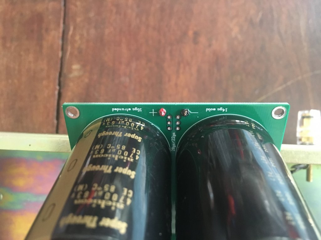

I just hooked it up to just under 24v of battery power and everything works just fine. Good to know that I'm not completely dead in the water. I will order 4 new rectifiers and see what happens with the antipole once they are installed. Any way to check the antipole before putting 120v to it and possibly having a repeat?  Could I put 12-20VAC to it and test it?  Folsom, the pic you are questioning is some sort of cell phone anomoly, here's a better one.

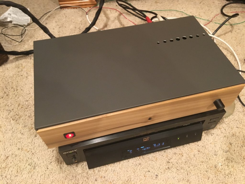

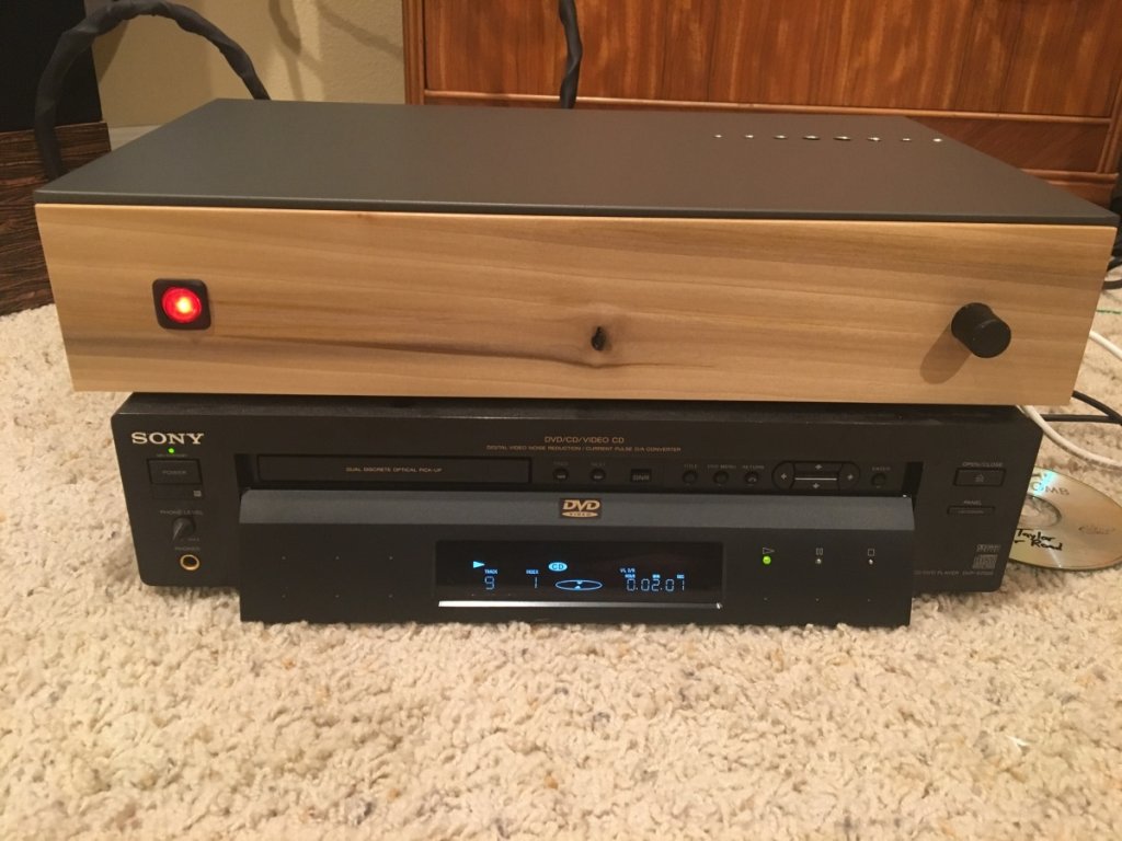

Happy to report that with new rectifiers installed all is well and working perfectly. Not sure what the original problem was?  Maybe a bad rectifier in the first batch?  That's kinda hard to imagine but I changed nothing on the antipole. A couple pics of my finished build with the Nabu case.
indosmokejon
  • Posts: 21
Re: Folsom's great little 7297 Chip Amp
« Reply #831 on: 16 Jun 2017, 06:55 pm »
Pics didn't load the first time.
