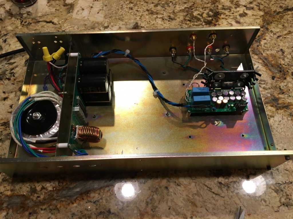

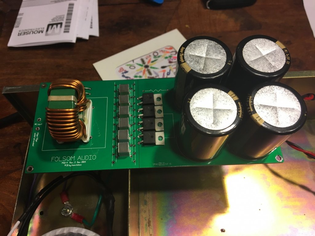

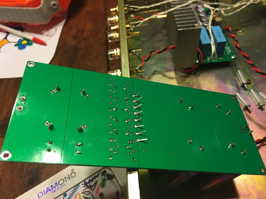

So I finished up my second Folsom, first one was fine, worked right out of the gate, this one unfortunately doesn't, so I am hoping for a little help. I am getting 16V AC to the antipole, but when I fire it up, the 300v 16A rectifiers start smoking?  The antipole is pretty simple, everything on it is non polarity besides the capacitors. Any suggestions?
Folsom
Re: Folsom's great little 7297 Chip Amp
« Reply #818 on: 11 Jun 2017, 05:19 am »
It looks like you drilled out the PCB board holes, probably causing a dead short.
Folsom
« Reply #819 on: 11 Jun 2017, 05:41 am »
The transformer might cook and weld itself before you trip the breaker, I guess... but something else should be failing before long if you leave it on. Sooo you need to use insulated mounts, basically, and replace diodes; maybe transformer if it is having heat issues, hopefully you didn't get that far.
