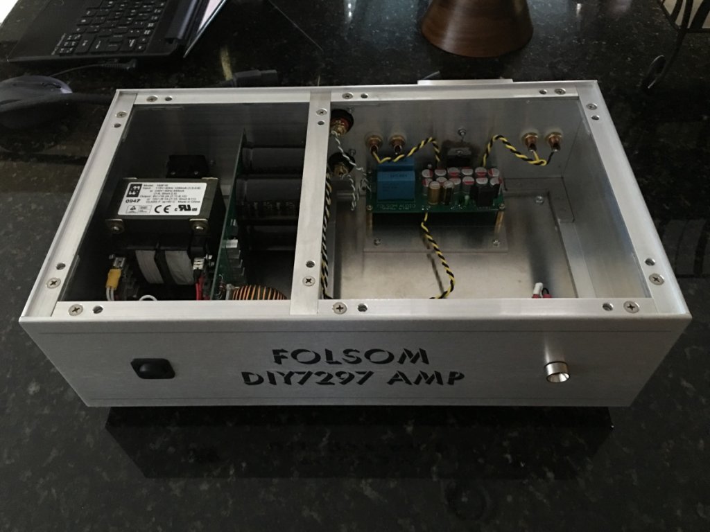

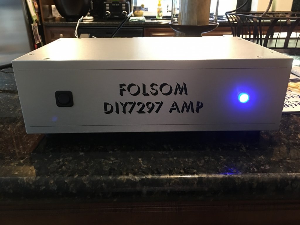

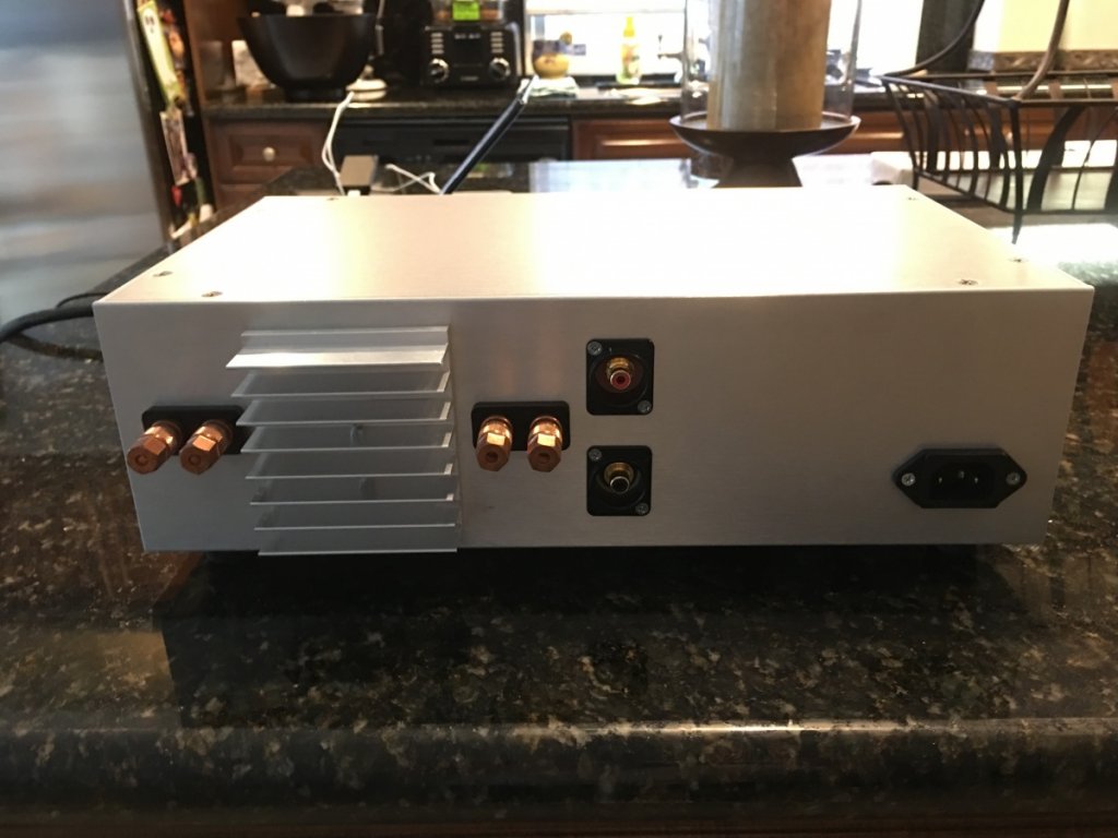

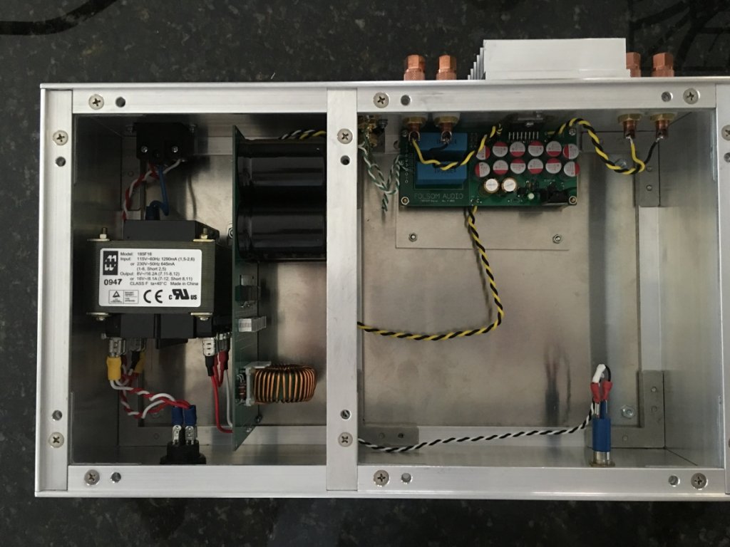

I finally built my amp. The boards came together easily. I did not run into any issues and everything fired up the first time. The chassis is from Landfall Systems. Dave was great work with and it's great being able to design a chassis the way you want it. In addition,the chassis has a great fit and finish. Well worth the cost.
The amp is fresh out of the box and needs to break in, but based on initial listening i think we have a winner. I'm going to let it break in over the next couple of weeks before I say anything else. I will say one thing, my Blumenstein Orca speakers like the extra power, over my Decware ZKIT1 amp.
Odal3
  • Posts: 864
Re: Folsom's great little 7297 Chip Amp
« Reply #339 on: 3 Jun 2016, 02:36 am »
That looks really good!!!   :thumb:
