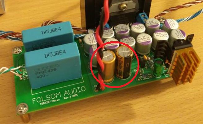

Folsom
Re: Folsom's great little 7297 Chip Amp
« Reply #279 on: 6 Apr 2016, 01:35 am »
Here's a photo of the caps I sent an email about, as they add stability because the inductance of the wires to the antipole is a little too high for the KMR section (resulting in some turn on noise, at least).
