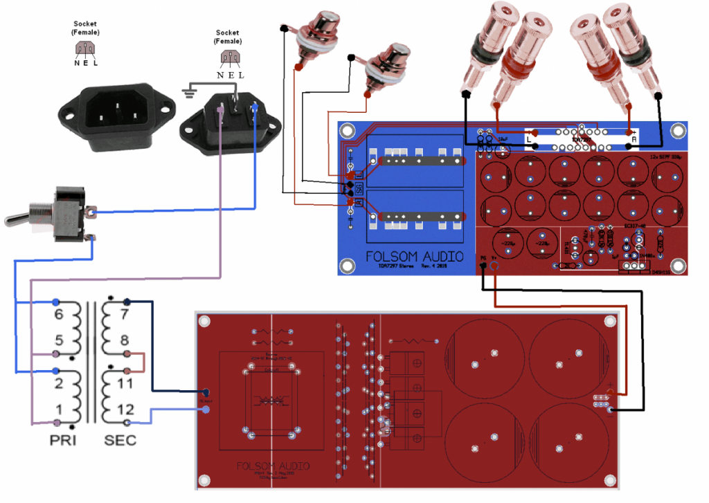

For some reason my paint program isn't doing yellow... or something. I'm going to reinstall it. I've got a few requests for this,

« Reply #201 on: 5 Mar 2016, 05:12 pm »
Thanks Jeremy, confirms everything.  I have the amp running o batteries, need to get some kind of enclosure for the PS.
Is the Antipole capable of powering more than one amp?
Folsom
Re: Folsom's great little 7297 Chip Amp
« Reply #202 on: 5 Mar 2016, 05:31 pm »
It can, yes.
