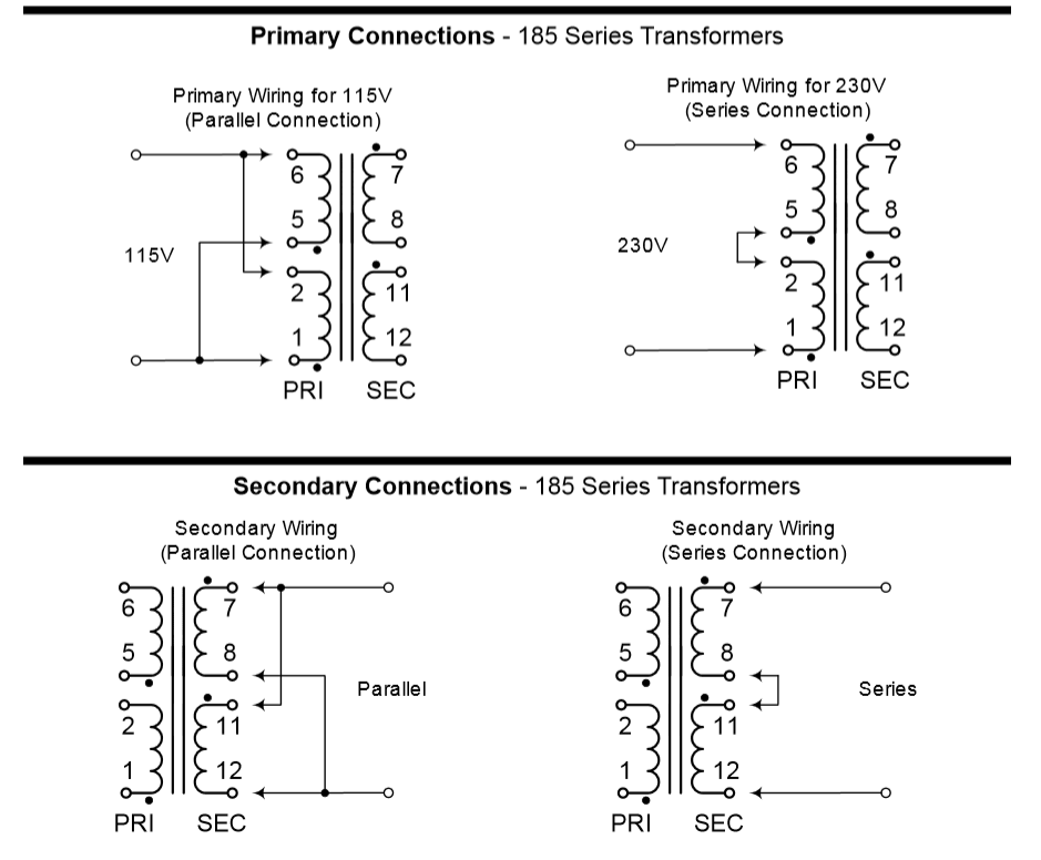

Please refer to the transformer diagram for wiring of it, if you’re using one. You need 16v out of the transformer before rectification (and 80+va). SMPS 21v min, and batteries 24v.
I assume the above quote from the construction notes PDF means that I can use 2 SLA batteries wired for 24 volts to power the amp.
I may get the amp board together and would like to get it powered up this way.
Will need some instruction later on wiring the trans in the PS.
Folsom
Re: Folsom's great little 7297 Chip Amp
« Reply #188 on: 28 Feb 2016, 11:09 pm »
That's correct, you can use two 12v batteries wired in series.
I'll post some photos on the transformer soon.

The datasheet for the transformer shows all you need. I don't think I'm going to draw anything better. The connections for 115/230v are your hot and neutral from your power inlet, hot being the one you'd put a switch on. To achieve 16v output you use the series configuration.
