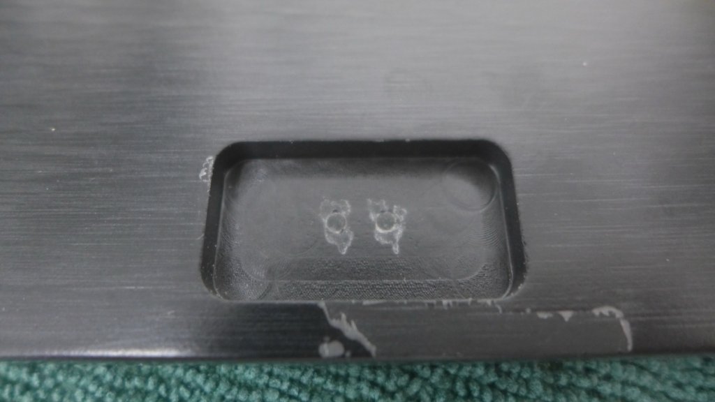

The following is minutia that has little to do with the actual amp, but it's fun for me because I learned some new things about LEDs and light fiber. I thought y'all might like it too.
 What I was after was to illuminate the eye sockets but not have piercing little LEDs staring back at me. Conclusion is no matter how much I dimmed the tower LEDs in the 2mm holes it was still more intense than I wanted. It seem to me it needed not just dimming but diffusion. Next step was 2mm light fiber which I've never worked with either.
The setup
The result. Still not what I'm after
I filed ends of fiber, stuck in holes from rear and ground flush
After more experimenting, I cut a little piece of clear acrylic and stuck LED into side.
Applied black out tape :)
To end up here.
I'll tidy things up, but it looks like I wanted now. I'll probably have nightmares about bright eyed dragonflies...

Thanks Wirenut. I actually used a 60° V cutter, but did spray with conversion varnish which probably makes the bottom of carving look rounded.
Made a mo' betta acrylic block, sprayed all but bottom side with texture black, glued in place, cleaned up wiring and Bob's your uncle. Lacro left a connector for me to plug LED into. I need to get a preamp figured out so I can listen to it!
Forgot to mention two people who were instrumental in getting this done. Lacro, take a bow.
Also Nick at          https://lighthouseleds.com/    who answered my many LED questions and supplied the LEDs and fiber optics.
