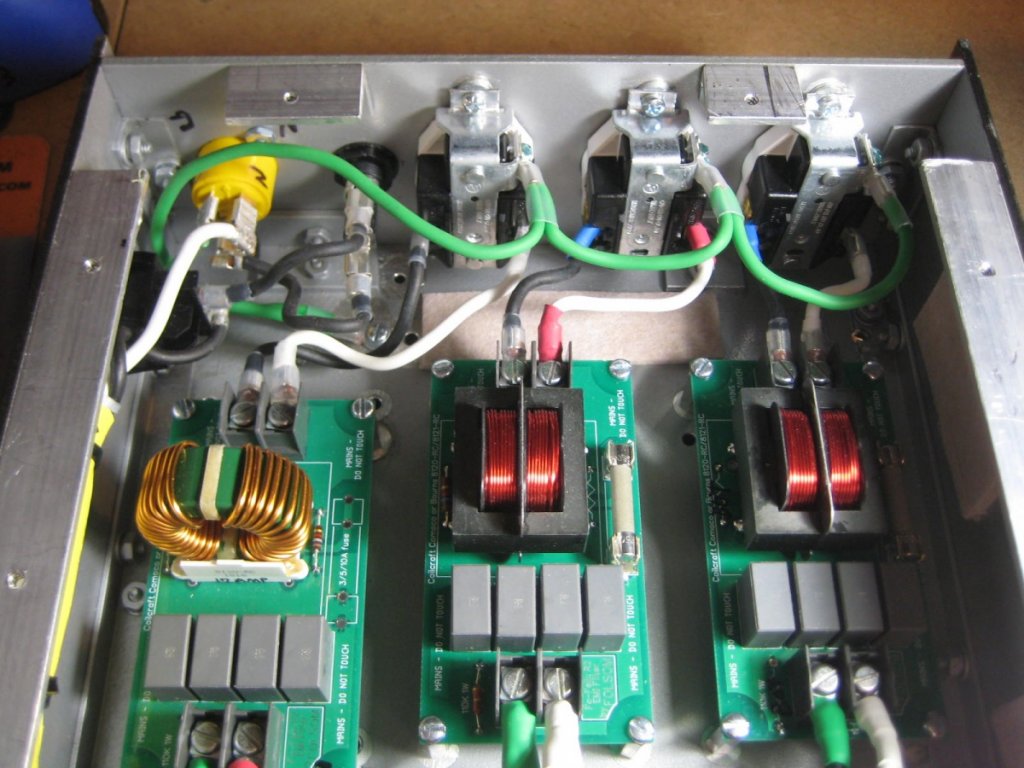

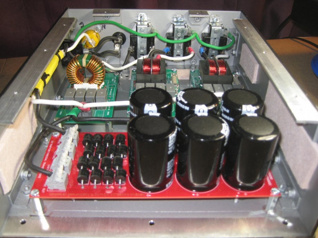

Peter J.
I built one of Jeremy's projects including three Fo-Felix filters, along with a DC Blocker into a single enclosure and I absolutely love it.
My plan is to build 4 of them given time.
Being retired, my old employer was nice enough to shear up enough pieces of aluminum sheet metal to build 4 enclosure's per my specs.
Thank you Roger Hasler.
With that sheet metal and aluminum angle iron purchased from Lowes I built my first unit pictured below.
Many audio purest won't like all the screws but I think they look pretty cool.
I didn't want to ask them to weld it together for me.
FWIW, If you can get scrap aluminum sheet metal for free and bolt it together with alum angle iron it will save you a lot of money and it's rewarding to do.
To me, the screw's look pretty cool but I'll try and keep them to a min on my next build.
Jeremy is a very good designer and I can't wait to build his amp.
Sorry Jeremy, didn't mean to derail. On with the thread.
