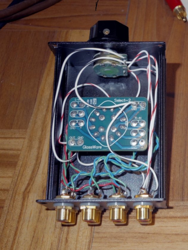

WireNut
Re: Folsom's great little 7297 Chip Amp
« Reply #1096 on: 22 Feb 2019, 08:33 pm »
Hi lacro,
This looks interesting. Can you tell me how it hooks up?
If I only have 1 input on an existing preamp will this add more inputs?
What are the rear RCA's, inputs/outputs?
Why 2 dials?
I don't get it, How does the DACT go before the input selector? Please explain. I put the DACT on the output of the selector.

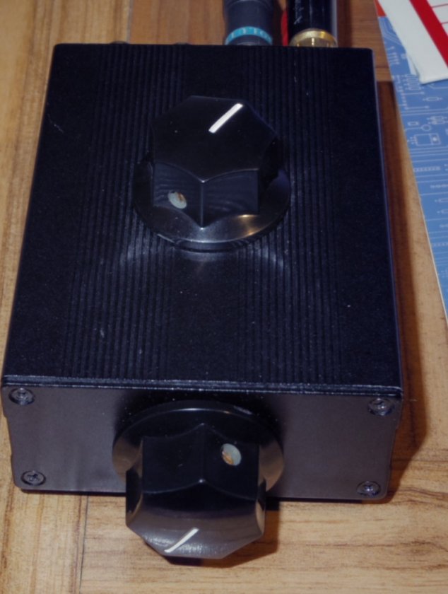

lacro
  • Posts: 602
« Reply #1097 on: 22 Feb 2019, 09:10 pm »
It's a Glassware audio 3 input selector with one output. Yes it would allow you to have multiple inputs to your preamp. The reason for the 2 knobs is one is for the selector, and the other is the DACT volume control. I originally made it as an input selector, but recently added the DACT pot making it a great sounding passive preamp with 3 inputs. If i did it again, I would add one more output for a powered sub.

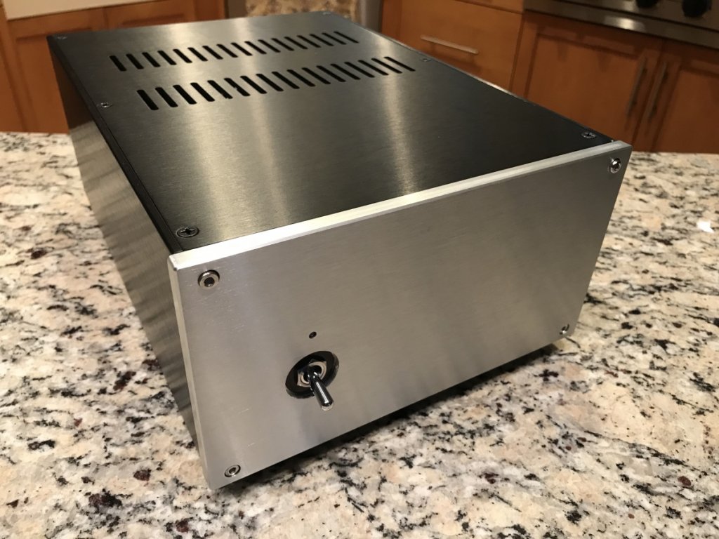

borism
« Reply #1099 on: 15 Mar 2019, 12:44 am »
It's alive! Sounds very nice on initial listen.
