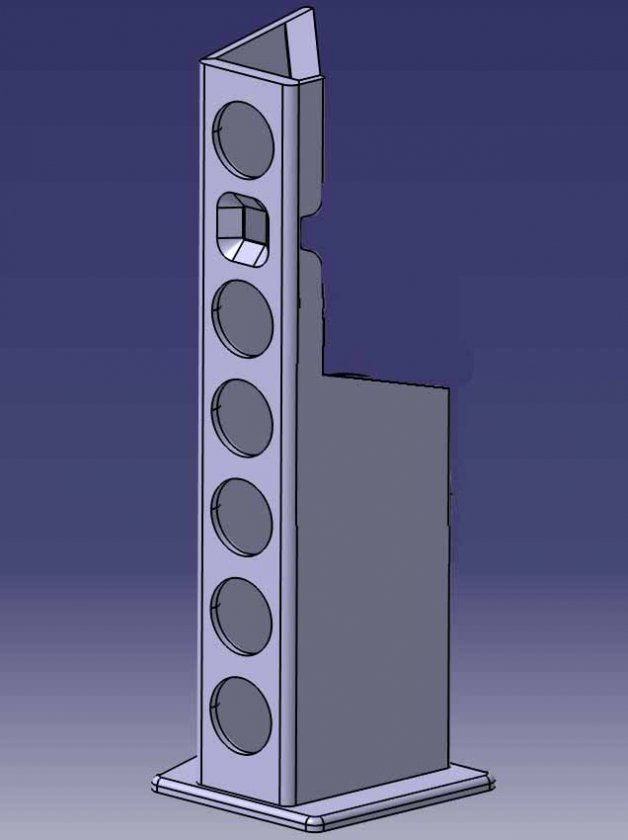

What are the dimensions of the NX-Otica?
Will the base for the NX-Otica look similar to the base for the NX-Treme?
And I assume No-Rez would be beneficial, too?
52.5" tall  before base, 8.5"  wide baffle, short wings are  2" off rear of baffle, long wings are 14" off rear of baffle,tweeter cutout is the same as above.  It will be similar to this  but there will be some  cosmetic changes as Danny mentioned (rounding of  corners, sloped tops on wings to match 8 degree slope on lower wing etc
Not a lot ofdiscussion  regarding basses yet. We just modeled them to  basically match the  shape of the cabinet.  I think the  NX-Treme will have an outrigger(s0 of some  sort
jay
