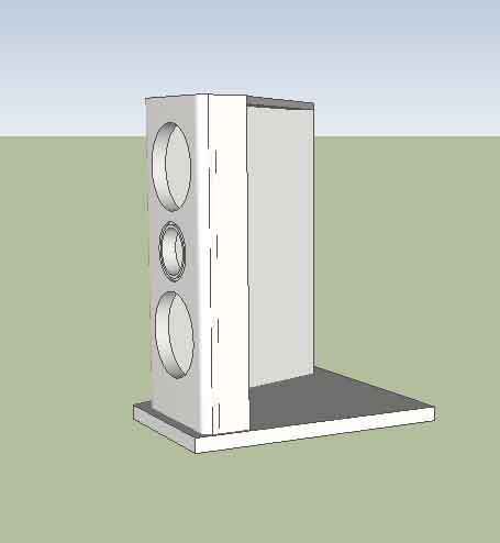

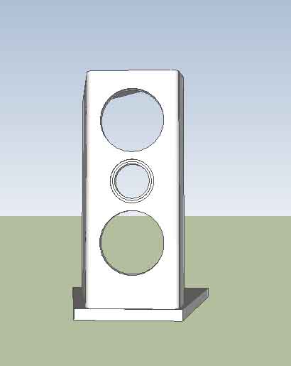

Well, those NQ's are really made for OB so what about an OB MTM  to sit on either stands or on top of ones subs....
I'd have suggested a MMTMM but I don't think the Peerless tweeter will play low enough   for the spacing required .....
-jay
-jay
Jay,
I like that idea and the Wedge bases can easily be built to fit, just make the front piece wider.
This seems like a good alternative for folks who don't have enough floor space for the full size speakers plus H-Frame subs.
Mike

For someone with a small room, MTM  :thumb: is ideal for me. It will also be a good introduction to the new driver without a bigger investment like the X-Otica.
I'm not certain but it looks to me like the top MTM section is similar to the Wedgies in that it rolls off at 200Hz which means midrange and treble only. If that is the case you won't be able to get by with just the MTM section, a subwoofer that can play up to 200Hz is going to be a must.
Mike
Danny Richie
Re: New X-Otica coming soon.
« Reply #76 on: 6 Dec 2015, 10:04 pm »
Yeah, you'll need something that can play up to 200Hz without that lower section.

Somewhat relevant to the thread. More about me (re)learning animations in SketchUp.
https://flic.kr/p/BsVucQ
I'll be starting a build thread when I start the ball rolling on these. Guaranteed to progress at glacial speed like most of my projects  :lol:
Arggghhh! Can someone tell me how to link to video on Flickr? OK, I think I got it...is link working for y'all?

Regarding the  MTM idea, I imagine  it wold be able to play a fair bit lower than the  Wedgies so the need for a  sub to play up to around 200hz  would be avoided.
Ideally, servo subs would be  great match, but if the MTM can extend down  to reach a c/o point of around 120hz,  at least a person could get by with a convential sub until he/she upgraed to servo subs.
jay
