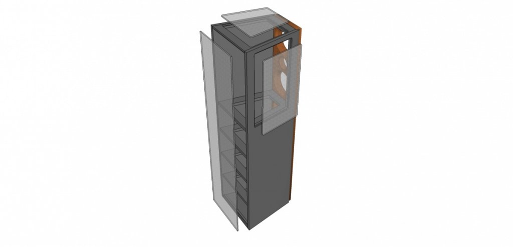

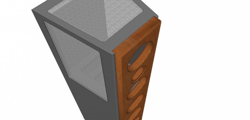

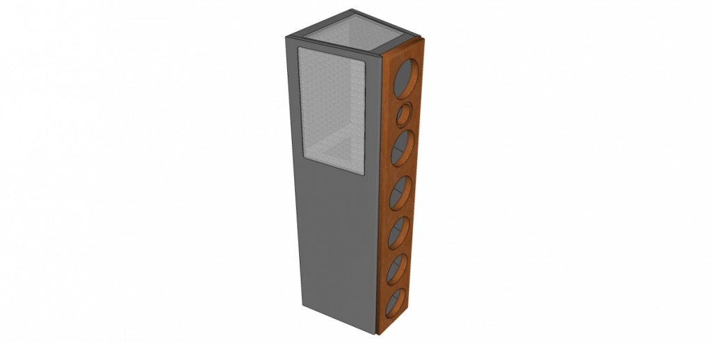

Now that Danny has green-lighted cabinet design, I spent a little time fleshing out drawing...these will get built.
 My intent with the cabinet "windows" was to give a framework for grills. Yeah, yeah, I know that grills mess with sound somewhat, but these will live in living room, with real world things like dust and grandkids. Don't fret, they will be removable and likely magnetically stored on side of cabinet.
And truth be told, I just don't want to be always looking at the insides of the box. Just doesn't sit well with my basement dwelling  troll mind, I guess
I'm also thinking about some legs/outriggers, but that will have to wait...I'm hungry...

The windows are a great idea.

Actually in this application I don't think the grills will have any effect.

I think the grills look great :thumb:
I keep my grills on the Super V's, I've taken them off and it does make a difference in sound but not that much and I just don't like looking at the subs facing different directions. I also have the grill on the back like the Super 7's and really like the finished look. Actually my speakers look a lot like Danny's Super 7's but I don't have the feet, like my Daughter used to say about certain foods when she was little "I can't like it"
Good Job everyone involved in these, they are nice!

The grills look great, just curious, did you think about putting them on the front also?

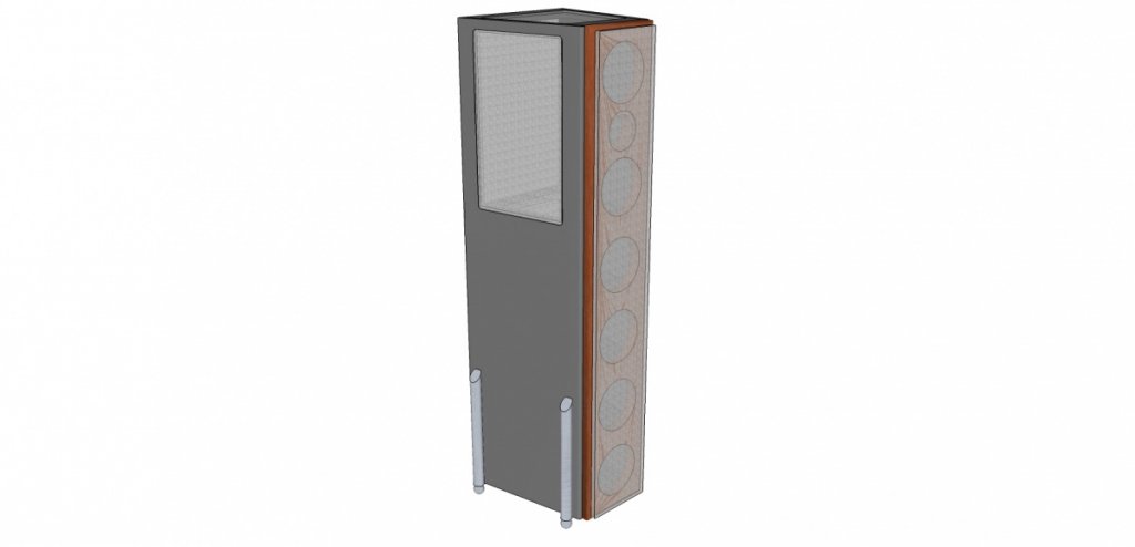

Danny, how do these speakers compare to the OB7's?
Thanks
Neil
As a matter of fact
Just hadn't gotten there yet! And some legs too.
I'd like to try some wire frame grills and new veneering techniques. So I'm thinking baffle will be veneered and box painted, but unsure what color.
