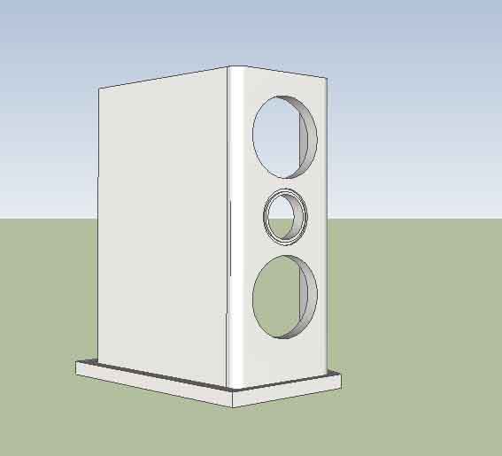

Well, those NQ's are really made for OB so what about an OB MTM  to sit on either stands or on top of ones subs....
I'd have suggested a MMTMM but I don't think the Peerless tweeter will play low enough   for the spacing required .....
-jay
How deep are the side wings here?  They look to be about 10 inches or so.  I know they have to be 14 inches deep for the lower four woofers in the floorstanding version but they have to play a lot lower.
Re: New X-Otica coming soon.
« Reply #102 on: 22 Dec 2015, 05:43 pm »
I  "drew" those in at 14" and 2"  on the outside.....  I think  you'll still want that inner wing  wide to  get  some  bass out of the NQ's.
That baffle is 21.5 tall,  (6 " to the center of the lower woofer, 11.5 to the  tweeter center, and  17" to the center of the top woofer) x 8.5" wide
Note, these have not been made up and sent to Danny for testing at this point
jay

I did measure the top section only and design a network for it only. So not a problem.
« Reply #104 on: 22 Dec 2015, 07:08 pm »
Right, forgot about that and I beleive Peter's PT's  had a 14" and 2" wing  right ?
jay
Danny Richie
« Reply #105 on: 22 Dec 2015, 07:44 pm »
jay
Yep.
