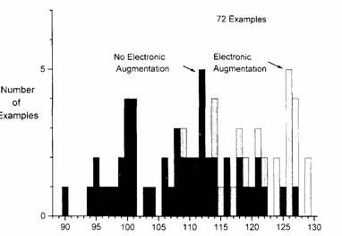

Acoustical music can actually be much louder than that. Check out this histogram, you'll see that measured peak levels on performances of acoustical music were as high as 127 dB:
It's from Felder's excellent paper on dynamic range requirements for digital audio:
http://www.zainea.com/Dynamic%20range.htm
For most classical performances, 120 dB at the listener's seat is probably adequate. Most conventional consumer loudspeakers can't do this, but some of the big ones can.

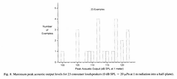

Here's another histogram from the Felder paper, this one of consumer loudspeaker peak SPL's, taken from reviews in Audio Magazine. it shows that they cover the gamut:
Horns and big loudspeakers like the Wilson are probably going to be at the top, with dynamics low to middle and planars lower to middle. So it depends very much on the speaker.
Pro monitors typically do 120 dB +.
