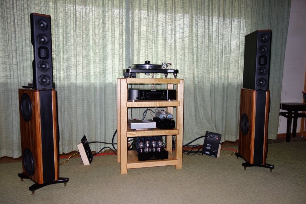

After 3 weeks of bad weather that I could not put the final coat of lacquer on, I finally finished the bases. Pictures can't show how
good Rosewood looks with a lacquer finish. Even the black spray painted parts look nice.
Having never heard a servo sub before and posts that seem to quickly want to dump them for 12" drivers, I was wondering if I had made the right decision going
with the 3-8"s. Well I am quite happy with them. They are incredible! Coming from a single 15" Hawthorne Augie per side the Wedge base is a HUGE step up in
performance. The only area the Augie outperforms the 3-8"s is in volume levels. The 3-8"s have a little more depth and impact than the Augies and everything else,
speed, detail, there is no comparison. The output levels of the 3-8"s has not once been an issue during the last 3 weeks of listening. They do have problems if
pushed but that is far louder than I ever listen to music.
These are quite small floor standing speakers and the amount and quality of sound they put out is incredible.
Since these are here to stay, next step is the matching Wedge top.

« Reply #22 on: 28 Dec 2015, 09:01 pm »
Wow, those look great.

« Reply #23 on: 28 Dec 2015, 09:44 pm »
Those look amazing! Very nice contrast and design. Could you tell me how tall they are finished?

« Reply #24 on: 29 Dec 2015, 12:55 am »
Geez, Keith. Those are stunning.  :thumb: I personally prefer the triple eights (based solely on viewing photos) over the 12s, but I hope to actually experience the wedgies at LSAF 2016 before deciding what is best for my situation (and my WAF, of course).
What size is your listening room?
and...
How far are the backs of the triple eights from the front wall/curtains (appears to be 2.5 ft)?
Merry Christmas, indeed!  8)
Edit: I just noticed the chair and round table in the background. That really demonstrates their compact size.

Keithh
  • Posts: 101
Re: Wedge Base Build
« Reply #29 on: 29 Dec 2015, 05:28 pm »
and...
The room is about 14x21x8 and your estimate of 2.5 feet is right. At Christmas time my speakers always get moved closer to the
wall and closer together just to be safe with company and kids coming over.
With spikes the bases are 29-3/4" tall and the total height of the speaker is 50-1/2" tall.

« Reply #31 on: 4 Jan 2016, 04:56 pm »
Christmas is over and tree is gone so I have the room back. At 2-1/2' between the back of the Wedge and the wall, The Wedge is the best speaker
I have ever heard so they could have been left there and I would have been happy. But I keep seeing the 3 or more feet figure, so they were moved out
to 3-1/2' from the wall. I was not expecting how big a change to the sound it would make. They are now at a completely different level!
The biggest change  was a completely 3 dimensional soundstage where the speakers just totally disappear and instruments are placed with pinpoint accuracy.
After the initial shock of incredible soundstage the Wedgies were producing, I then noticed they were putting out quite a bit more output. It not just loudness but also a great deal more weight given to the music. There is much more fullness and body to instruments now. When a piano key is struck you can feel it too as opposed to just hearing it.
My Tortuga preamp shows volume levels with a numerical display and I normally listen to music at about 45. Now the same volume is 38. Also while having no problems with the output levels before they now reach much higher volume levels. The Wedgies with good recordings now are getting pretty close to lifelike.
Experiment with the position of your OB speakers, even though they might sound great now, one foot more from the wall may totally transform them.

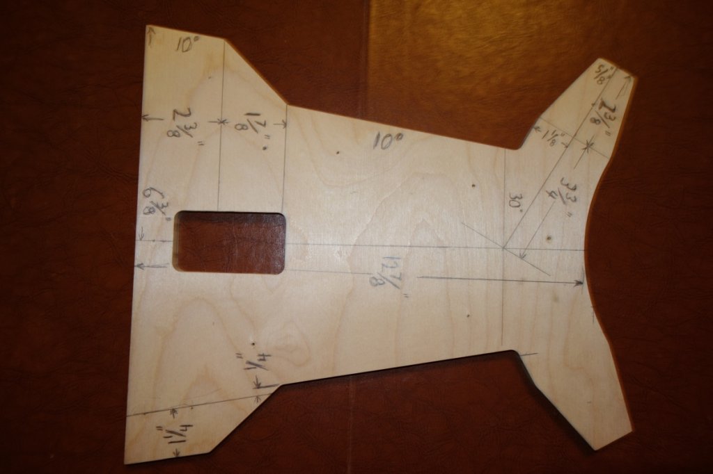

Keithh,
Would you mind sharing the dimensions you used for the outrigger portions of your base? I finally got around to bolting on the two tiered rectangular plinth I built for my wedge bass units and I don't like the looks.
Mike

Keithh
  • Posts: 101
« Reply #38 on: 18 Jan 2016, 04:09 pm »
This is the template used to cut out the base.
The overall dimensions are 14-1/4" deep, 11-1/8" wide at the front and 12-3/4" wide in the back.
Hope you can read everything on the picture. I didn't really have any dimensions at first, I just traced the outline of the Wedge base
on a sheet of plywood and started cutting pieces on the miter saw and screwing them down to the plywood until I liked the shape.
The sides and the center point of the front are recessed about 1/4" in from the Wedge base. There is a 5" or 6" radius in front and the front
legs come out at 30 degrees. The legs are 2-1/4" wide tapering to 1-1/4" at the end. I see one dimension I forgot is where the 30 degree
line intersects with the centerline. It is 10-1/2".
