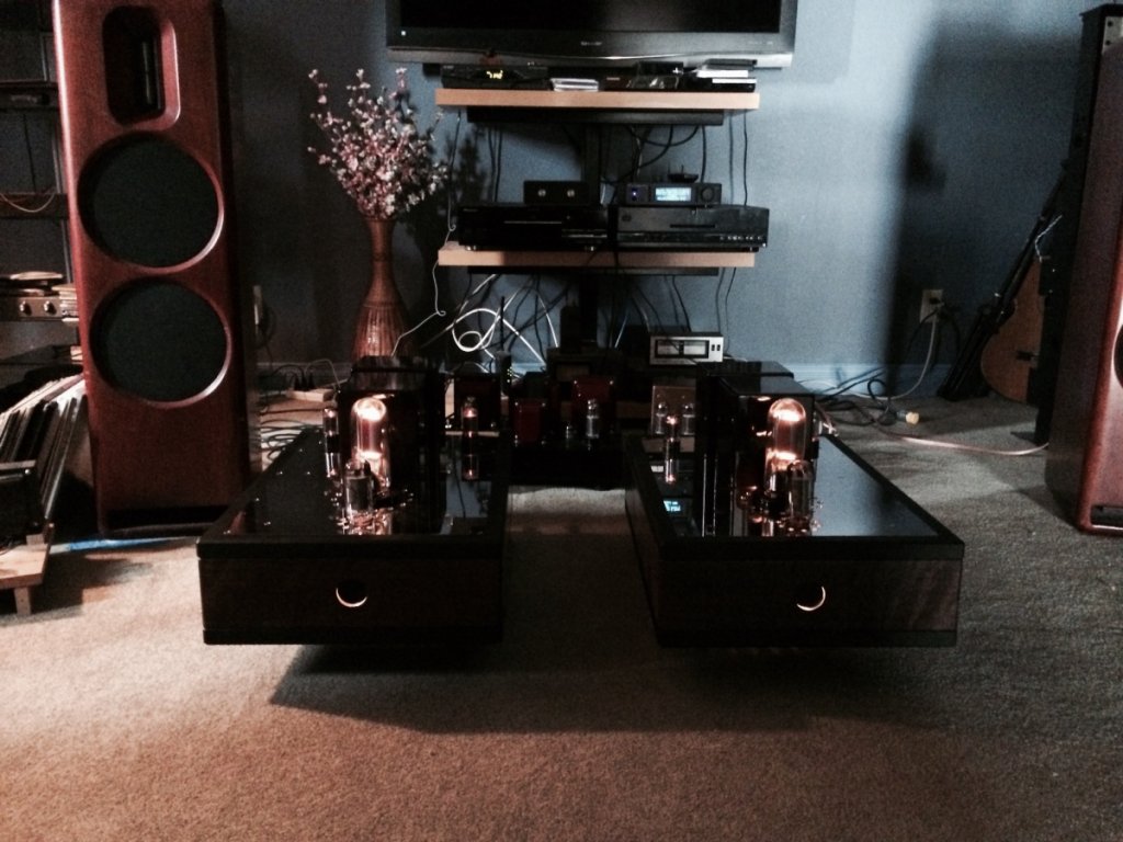

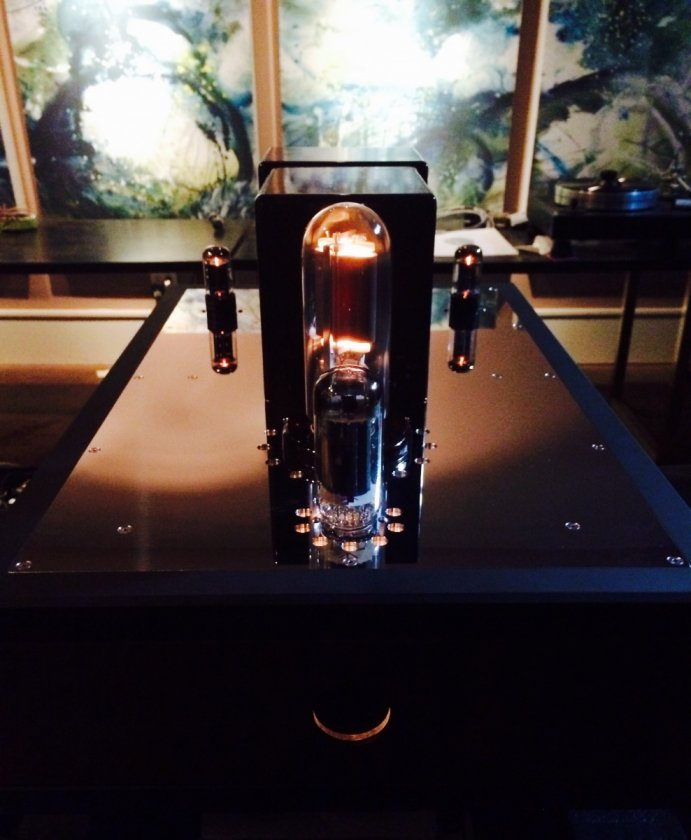

845 DS - 32W SET amplifier, Cost No Object Mono Blocks!

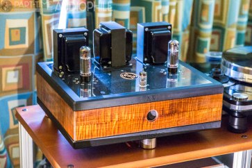

Ambrose 10W SE EL34 stereo amp.

You had to introduce the 845 amps the year I can't attend.  :evil:
I just hope the amps have enough headroom with the 91 dB E-5s.  I know the cabling is good -- I got them.

Hi Guys, the Ambrose and 845 DS designs are both finalized and I am working on reviews for both.
I just returned from Las Vegas where we further optimized the 845 DS monoblocks with a small adjustment to the design which further reduced THD by up to 75% and IMD by up to 50%.  We had a great showing with the local Las Vegas audio society and the amps were very well received.
The Ambrose as shown is a 10W stereo amp.  We can also make a 20W stereo amp or 20W monoblocks.  For that design, 20W is the maximum power that we can achieve from an EL34 SE design.  The cost really depends on the finish of the enclosure.  The 10W Ambrose as shown in DC and at RMAF is $9995 retail, with flamed maple and EXPENSIVE solid billet AL enclosure details.  I know that we could offer the same design in a less exotic enclosure at a lower price.
Both pieces were built as concept designs and I took the Ambrose to Capital Audiofest first and then the 845 DS mono blocks to RMAF and have been honestly waiting to see what market acceptance is for such designs.
I really need to know what interest there is in 10W, 20W and 34W SE/SET designs.

I have only compared the 10W EL34 amp to the 150SE and it IS enough power, unless you are in a BIG room.  The 150SE has a bit better control, but lacks the beauty of tubes that the 10W amp provides.  I DID hear the 20W version at Jack Elliano's last week, compared directly to a 10W version and the presence and control was SIGNIFICANT!  I am thinking that 20W monos simply make more sense all the way around. The 20W EL34 design would close the gap in terms of control, compared to the 150SE and still offer the beauty of tubes.
The 845's are the best sounding of the lot, in terms of presence, 3D soundstaging and the things that SET's JUST DO WELL!  This also comes at a price however, because the tubes and 'iron' to create them are simply not cheap.
