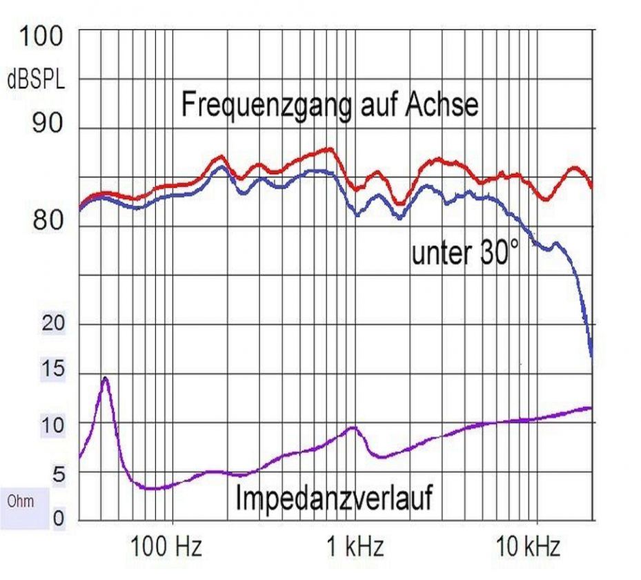

Dynaudio Confidence 50: frequency & impedance
Rescaled (as NX-Xtreme scale)
