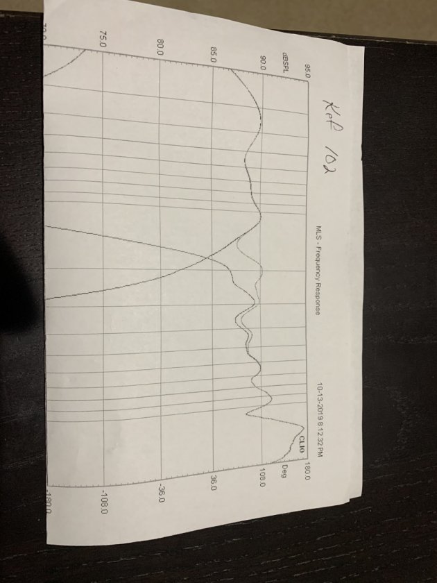

i did find a review on avhub.com with fairly extensive measurements.sorry, i couldn't post a link.

thanks for posting the links.what is your take on this set of measurements?

More measures are missing, such as only the tweeter, the impedance and phase graph and the CSD. And, most importantly, the frequency response at the listening point in your room. If it is in the near field everything is easier.
It is pretty good. With a slight answer in "V" that rockers -JBL lovers- like but that I would soften.
I would first try to flatten the answer without abusing, focusing on the tweeter. With a minimum phase PEQ in a good software player.
First brute attack with an only filter at 8 kHz. -3 dB and Q=0.8 (proportional aka RBJ filter).
https://wiki.jriver.com/index.php/Parametric_Equalizer

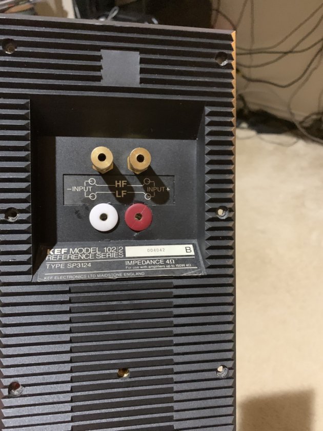

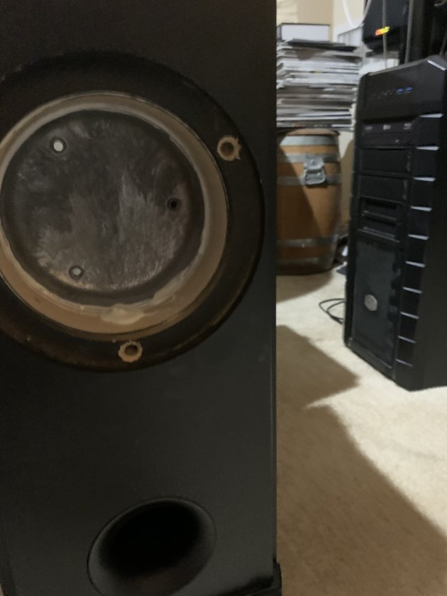

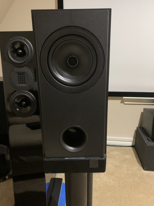

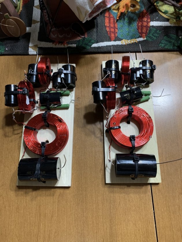

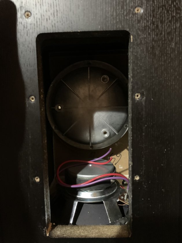

Danny has created a new crossover for my KEF 102.2's
These were made in 1995. I have owned them for the last 15 years.
They do sound much better that they ever have.
Front of the speaker
Old Crossover
New crossover, first attempt to build one. Picture missing huge coil for the woofer
Drivers removed, Back of mid/tweeter is aluminum shell.
Back of cabinet with woofer. Cabinets are about 1.25' thick

I guess the two speaker connectors work. Have you noticed much improvement with the new ones? By the way, in Europe I have not seen them anywhere!
https://www.canuckaudiomart.com/details/649176604-kef-reference-1022-kube/images/904140/
[PDF] https://us.kef.com/pub/media/pdf/Reference_Series_Models_101_2_and_102_2.pdf

I didn't put any No Res in the cabinets. The cabinet is thick enough. When tapping on them they are very solid.
maty
Re: I bet I can make your speakers sound better.
« Reply #229 on: 14 Dec 2019, 08:33 pm »
I wrote the question before adding the image in which thick walls of chipboard are appreciated.
But... I am surprised that it weighs so little, only 11 Kg.

My compliments to GR-Research and Danny for assessing my Dali Option 2 speaker and recommending the optimal upgrades.  I have no prior experience with assembling a cross over network or even reading a wiring schematic.  But after watching a number of You Tube videos and especially the Klipsch upgrade series on New Day Record I felt I could do it.  Finding a way to get the cross over components laid out on a board that would fit inside my small speaker cabinet was the most challenging part for me, but it all worked out.  It may not be the prettiest of work, but it was my first attempt, and everything worked!   It probably only took me 4 hours total time to complete the upgrade start to finish.  So for those of you that may be wondering if the effort and (small) cost of doing the upgrade yourself, I'd say go for it.  There are lots of members at AudioCircle that no doubt could provide some help if you have a question.
