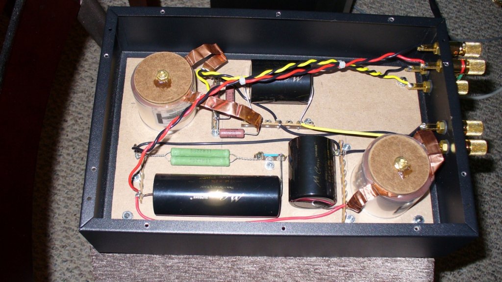

Looking forward to the pics and your assessment of the expected improvement in sound.
Thanks!
Got the speakers back yesterday.  Although the crossovers still need to break-in, I can safely report that the improvement is nothing short of astounding.

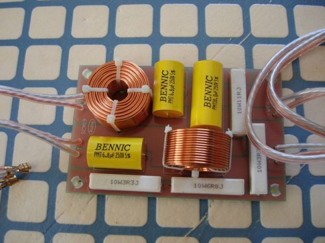

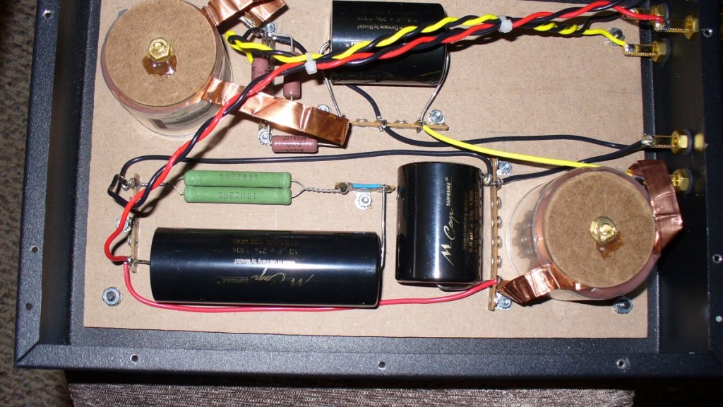

The parts take up most of a 8" by 12" enclosure.  Compare to the stock unit:
The sound is much improved across the entire audio spectrum.  The bass is fuller, yet tighter.  The mid-range is significantly improved in clarity, and the treble sounds as if a new and improved tweeter is in the speaker.  Given what manufactures charge for their better speakers, makes one wonder why they often don't put better parts in the crossovers.  I got a education some time back when I had crossovers re-done in a pair of Legacy speakers.  The parts in those were not very good quality.
The improvement is so good, that I would put this up against the V.2 version of the SCM 19, and I bet this would sound better.  The major difference is the V.2 has a new tweeter, made in house vice the scanspeak in the V1.  The woofer/mid is the same.
Danny, I am floored at the difference.  The fact that I have a second set of stock speakers to compare them to really allows the differences to be focused on.
I'll post an update in a week or two after the caps break in.  Should only get better.

Post some pics and feedback when you get a chance.
Copy that.  Just posted the update.   :D

I don't disagree, but I won't say no to possibilities. I've been trying to think of ways to encourage what I want. Do you have a picture of the bottom of the PCB board? I can open my speakers, but it's much harder than looking at a JPEG.

I'm not a big fan of those caps. But they are a big improvement over what was stock.
Lots of binding posts in there as well. Those equal a lot of insertion loss. Some tube connectors would be a big improvement. I'd highly recommend them.

I don't have a schematic, or a picture of the bottom on hand. I've come up with one minor change that might do what I'd like with the X-LS. Again, I don't think there's a lot of room for improvement, but I believe there's a minor possibility without having to graduate to a whole new class of speaker.
Well, I have all of that information and I know what those woofers are capable of. Give me a call and I'll go over some options with you that will take them up a notch.
Well, so far, I'm noticing a huge improvement in sound.  I can certainly look into tube connectors.
What caps do you like?  I have always liked Mundorf caps.

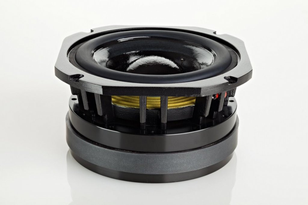

BTW, I really like the woofer in this speaker.  Hard to find a better built 6" driver.
Looks a bit anemic and wimpy.  ;)
I prefer the Sonicaps for this application. They are a little clearly and preserve the imaging and sound stage a little better. And the tube connectors are huge. I am more impressed with them every time I get to A/B them with anything else.
This woofer reminds me of what I see all the time in car audio. They put a motor structure on a woofer that is three or four times what it needs to be then just increase the distance in the gap to drop the field strength back down. They could keep a tighter gap and drop the magnet weight, but that would require higher assembly tolerances and it would loose the look of having a big magnet. And be magnets sell product.
And for me I would rather see some venting below the spider and a non resonant polymer frame.
Looks good though huh?
Thanks for the feedback.  I'm going to keep the Mundorf caps, as I really like them.  I can look into tube connectors.
I also need to make a second set of crossovers for my other speakers.  I may look into Sonicaps.  I used Jupiter caps in the 6883B power amps (as opposed to Mundorfs in the 1625 amps), and they sound excellent.
Trust me, it sounds VERY good as well.  Have not heard a better 6" driver yet.
