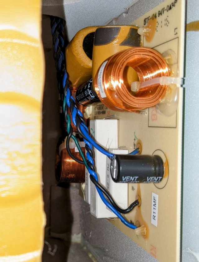

We've had the large R11 towers in that are similar, but all of the modern, mid and high-end Kef speakers are loaded with bracing that makes it difficult to install new crossovers, not to mention that the stock crossovers are also glued onto pegs that can't be removed non-destructively.
Here is the tweeter/mid crossover on the R11.
Best non-destructive option to upgrade them would be to simply line the cabinets with NoRez, leaving about 2 inches away from the opening of the woofers to allow the woofers to breathe.
They're well braced, but had almost no stuffing or Polyfil, if i remember correctly, except for the area behind the tweeter/mid.
The smaller LS50 Meta did have a decent amount of open-cell foam in them.
