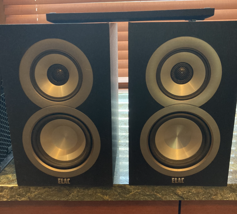

PeterHS
  • Posts: 5
Re: I bet I can make your speakers sound better.
« Reply #337 on: 19 Jun 2022, 12:32 pm »
Hey Danny these are OK but should be better - do you have a solution?
Hobbsmeerkat
  • Posts: 2741
« Reply #338 on: 19 Jun 2022, 02:22 pm »
We've had those in before, but they're too small to fit a full-size 3-way crossover, so we didn't design one for them.
Elac tends to use some pretty good crossover design, so upgrading the caps and resistors maybe the best way to go.
