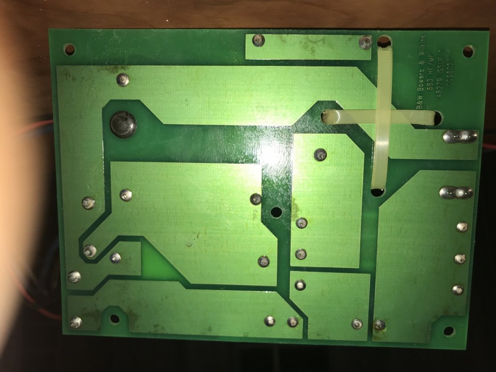

This weekend I'm going to disassemble one of them to inspect it. I can share pictures so you can see if something is damage.

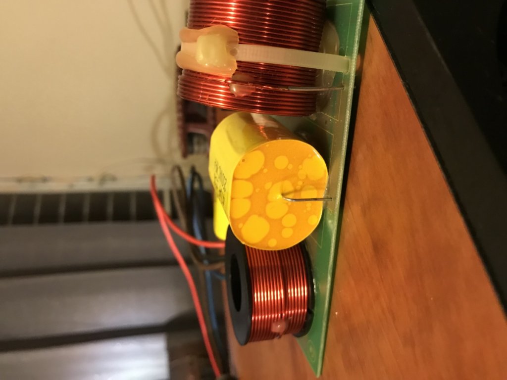

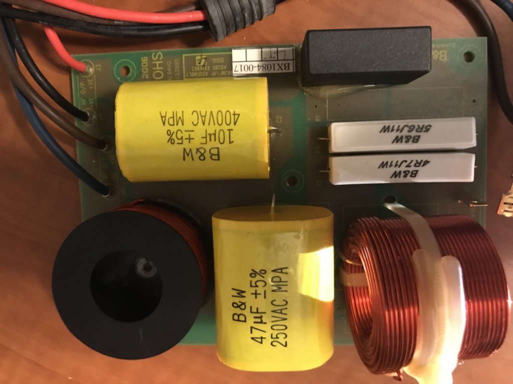

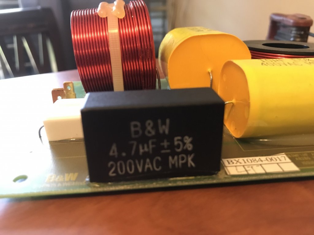

Here are the pictures of the HF/MF Crossover. I also connect the tweeter to the MID connectors for a few seconds and it sounded ok. So for sure there is something with some components in crossover.
Nothing looks burned up or anything, but there is likely a failure somewhere there if the tweeter works on the mid circuit but not too well on the tweeter circuit.
If you want you can send me those crossovers and I can measure the parts on them and figure out what failed.
Then you might want to upgrade some of those caps and resistors (the resistors are real cheesy) and then re-install it all.

Got my crossovers back from Danny. Beautiful work, as expected.  Now the speakers sound amazing. Next project would be No-Rez.  Thanks Danny for your work.
