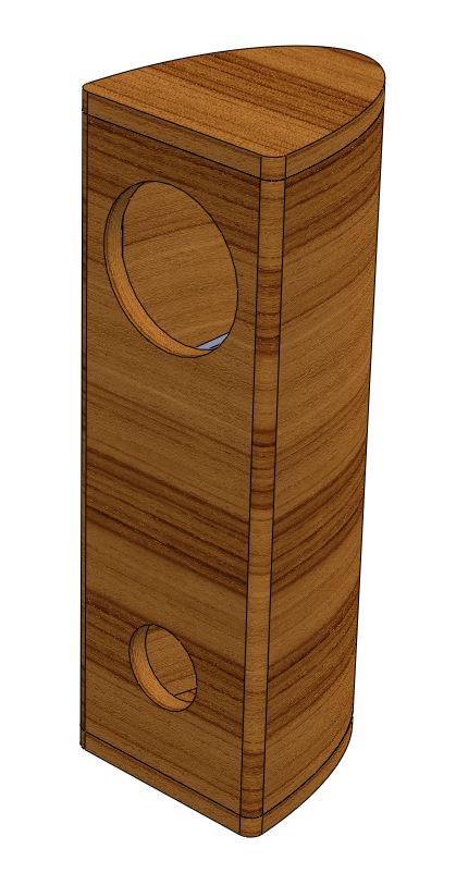

We've been evaluating the Audio Nirvana 10" classic drivers in plain vanilla 2.8 cubic feet cabinet for a few weeks now. With appropriate tuning of the response curve via DSP these drivers are really quite spectacular. Great solid tight bass and amazing detail. Sublime with great recordings and merciless on badly recorded material.
Before making a final decision we're going to also audition the Audio Nirvana 12" Super driver. The 12's should further improve both the bass and the mid range quality. Since it uses the same ALNICO magnet size as the 10's, expectations are a somewhat more relaxed and toned down upper end. Also, due to the size of this driver the physical depth of the speaker cone, we're opting for the Super model with the whizzer cone on these 12's. The whizzers will help the dispersion with the deeper cones on the 12's which might otherwise be a bit to beamy.
Once we've evaluated the 12's we'll make a final decision on driver and cabinet size.  The CAD pic below shows the prototype cabinet size with the 12's. It would be 16" wide x 17" deep x 41" tall and be roughly 3 cubic feet in volume. Oh, and the walls are 1.5 inches thick including the top and bottom. PLUS there's longitudinal X & Y bracing running internally between the driver opening and the baffle opening. A most stiff rigid beast of a cabinet that will also be a beautiful head turning piece of audio gear artwork.

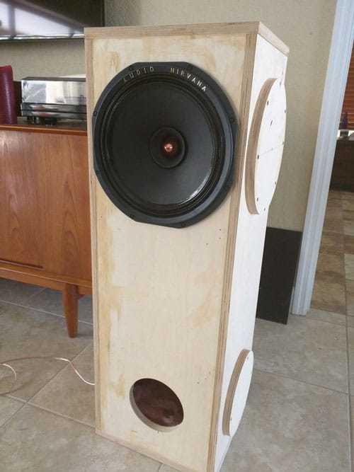

Having tried the 10" Audio Nirvana Classic in our test cabinet, I decided it wasn't quite good enough for what we are looking for. Good but not great. So we moved on to the 12" Audio Nirvana full range driver. Except this time it was the Super and not the Classic. The Supers have the whizzer cone. The concern being that with the a full range driver as large and deep as the AN12S there would be horizontal dispersion and beaming issues with the classic which has no whizzer.
Even though we only have a dozen hours on the 12" so far, it really delivers especially in the mid-bass and with vocals which just come across so naturally. We are still tweaking the response curve with a DSP to optimize the sound quality and the results are really wonderful. The 12" really projects sound efficiently and we noticed we tend to run these turned down further than the 10's. Bass is good as well.
The pic below is speaker sausage making at its finest. This is just a test cabinet and obviously not a boat hull. Note the round covers on the right side which is where the 10" drivers used to be. The 12's just wouldn't fit so we rotated the cabinet 90 degrees and made new openings for the 12" driver and port. The cabinet is 14" wide and 12" drivers only have about 3/4" room on either edge.
We are going with the 12's. Next  step is to build our first full size 3 cubic foot boathull cabinets for these 12" drivers.
