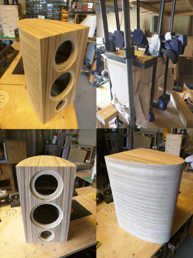

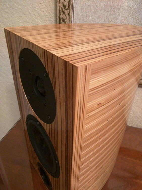

Now that we have our CNC router/mill up and running again I've been able to move our 0.32 cubic foot boathull speaker cabinets closer to completion.
The baffle has now been bonded to the body. While not visible in these pics we lined most of interior with heavy felt. Being our first boathull build we had to figure things out along the way. Note the clamping cradle. Without that cradle it would have been tough clamping on to a curved surface.  :scratch:  The zebra wood veneer is turning out to be an outstanding match for the baltic birch laminate body. Fine sanding and poly oil finishing comes next. Note that the speaker terminals are not yet installed. These speakers will use an external crossover and will be set up for bi-amping.
I'll post one final set of pics once they are completely done.

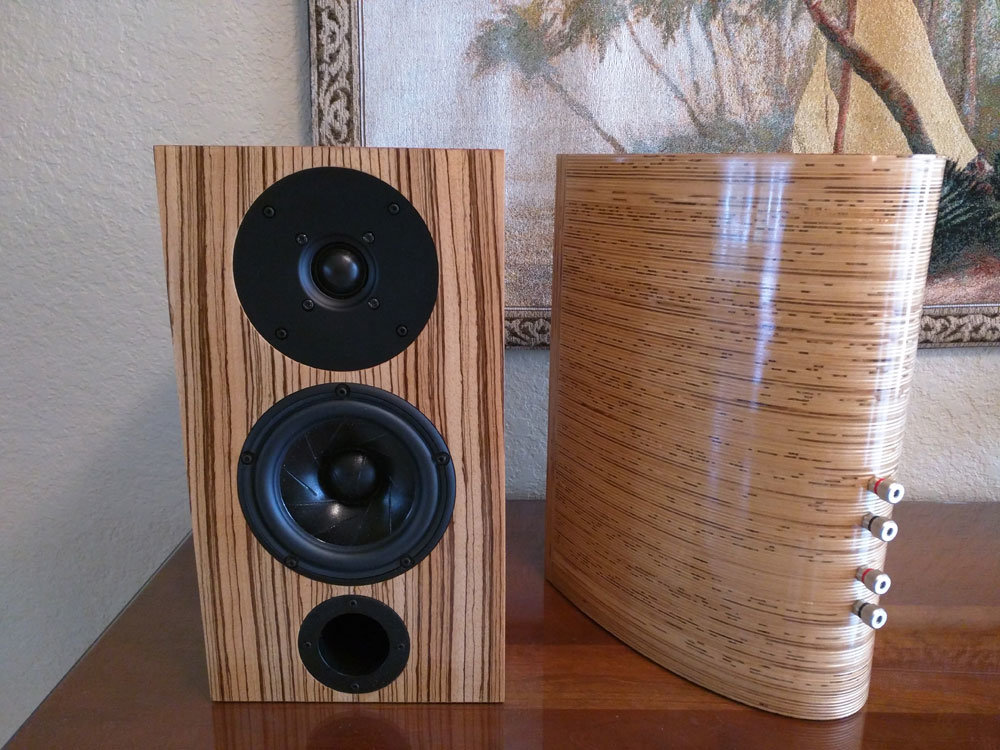

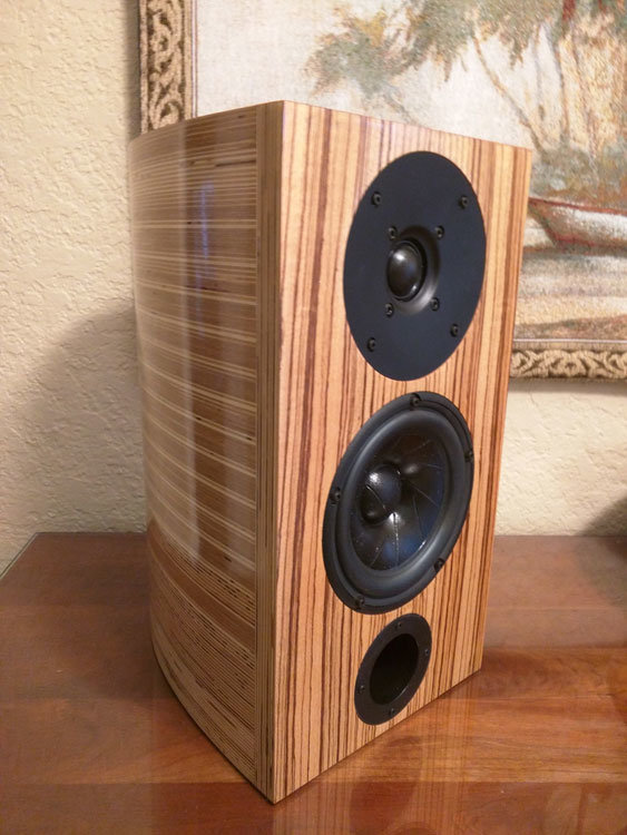

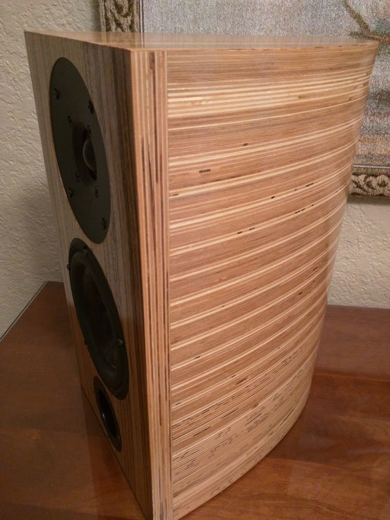

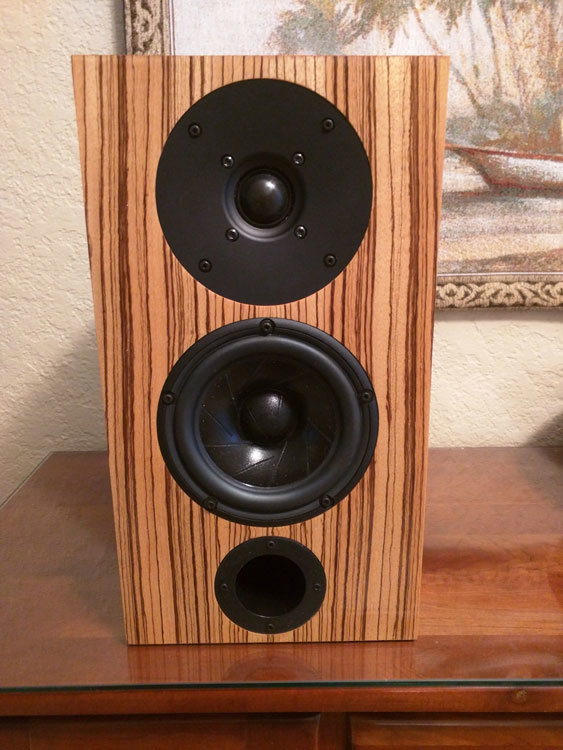

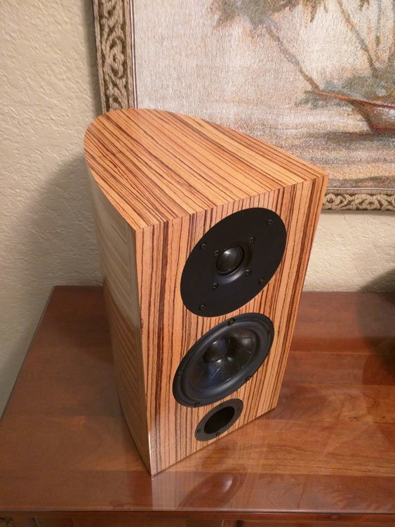

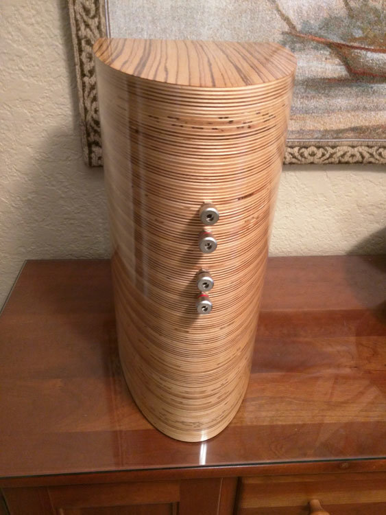

Here are pics of the finished "boathull" 0.32 cubic foot speaker cabinets. Made of milled baltic birch plywood with zebra wood veneer on top, bottom and baffle. Body is ellipsoid (boat hull) in shape - 1 inch thick walls. Finished in about 10 layers of gloss poly oil.
Woofer is a Scanspeak Revelator 15W/8530K00
Tweeter is a Scanspeak Revelator D2905/990000
Customer wanted these built without crossovers so unfortunately I'm not going to get to have a proper listen before shipping them out...but that was the arrangement. They are set up for external crossover/bi-amping.
There's a reason most speaker cabinets are simple rectangular boxes - cheap and easy. These are neither. Very unique and quite stunning to look at. Each cabinet is unique with its own laminate pattern depending on the random nature of the baltic birch in the plywood.
Our next build will be a set of floor standers, probably 44 inches tall, 13.5 inches wide with 10" Audio Nirvana full range drivers. Considering making those with continuous integral baltic birch all the way around - no separate front baffle to attach. That build will become our standard design.
Please contact me if you, or anybody you know, is interested in a set of custom make cabinets using this construction technique. At this point we're only planning to build these to order.

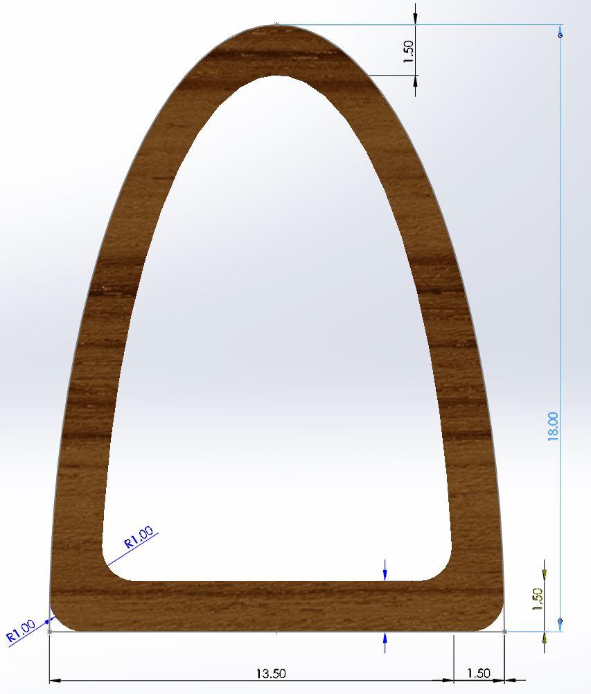

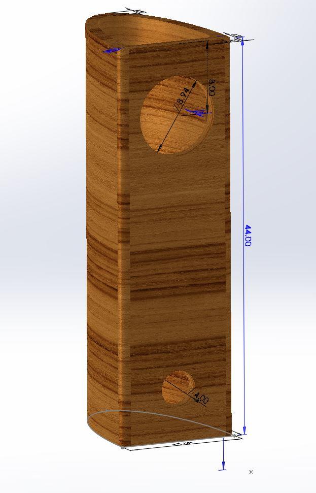

Here's a CAD rendering of the full range boathull speaker cabinet. Note that unlike the initial bookshelf design the baffle will be integral and not a separate attached panel.

« Reply #53 on: 2 Feb 2016, 05:18 pm »
Cool... I'd put a flat spot for the binding posts so they can be side-by-side and build bracing and damping into the design too...
Folsom
Re: "Boathull" custom milled speakers/cabinets
« Reply #54 on: 2 Feb 2016, 05:55 pm »
Yes, those binding posts might be awfully difficult with large, maybe stiff, speaker cables.
tortugaranger
  • Posts: 1779
    • Tortuga Audio
« Reply #55 on: 2 Feb 2016, 06:52 pm »
I don't understand the concern here regarding large/stiff cable. Not that I disagree, I simply don't comprehend how the over/under binding post configuration might pose a problem especially if they're sufficiently spaced that would be somehow less of a problem if they were side by side.
Also, to Craig's earlier comment, creating a sufficient flat spot on the given curvature to allow for side-by-side binding posts has its own issues. First, keep in mind that the walls here are 1.5 inches thick. Let's say we create a flat spot sufficient for binding posts 3 inches apart. Given the degree of curvature those posts would have to be considerably longer possibly exceeding available lengths of most/all binding posts. Flat spots would also create a more complex surface to smooth and finish properly. Anything is doable of course but need a very compelling reason to create new problem in order solve a problem that may not be one (or that I don't recognize as a problem - yet).
