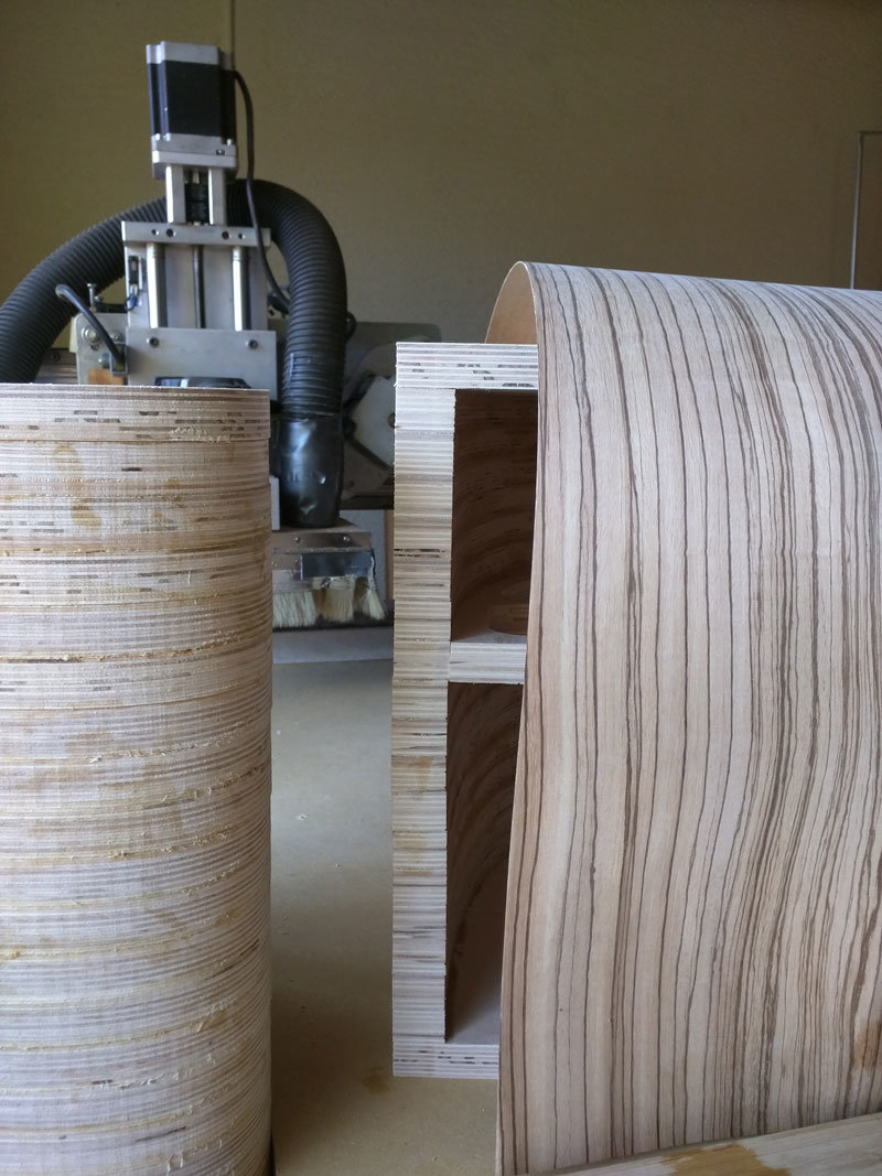

Zebra wood veneer selected for the top, bottom and baffle. Should look quite sharp when done with both the horizontal and vertical lines and complimentary wood tones.

Just curious why cut the "Brace" in a separate panel to insert? Why not just make it a single piece simply cutting it into the same piece of ply used for that external "U" as well? Seems you would end up with an even more solid construction, and simply remove the fitment variations in the end.
Thanks

Just curious why would you cut the "Brace" in a separate panel to insert? Why not just make it a single piece simply cutting it into the same piece of ply used for that external "U" as well? Seems you would end up with an even more solid construction, and simply remove the fitment variations in the end.
Thanks
An excellent point! Although once properly glued in place a conforming brace would be arguably indistinguishable from an integral continuous "slice" from a structural standpoint. The real answer in this instance is I didn't know exactly where the internal brace was going to be located since there's still some back on forth on a few design details so a flexible "put it anywhere" brace was the way to go. As it turns out I may need to redesign the brace to accommodate the port so good thing it's not already permanently built into the stack or glued in place.

I agree... I guess though with a larger cabinet it would be a big time saver to just cut multiple braces using them integral to each piece if you know they will be out of the way. Nice cabinets.
Next time around, we'll definitely take this approach.  :thumb:
