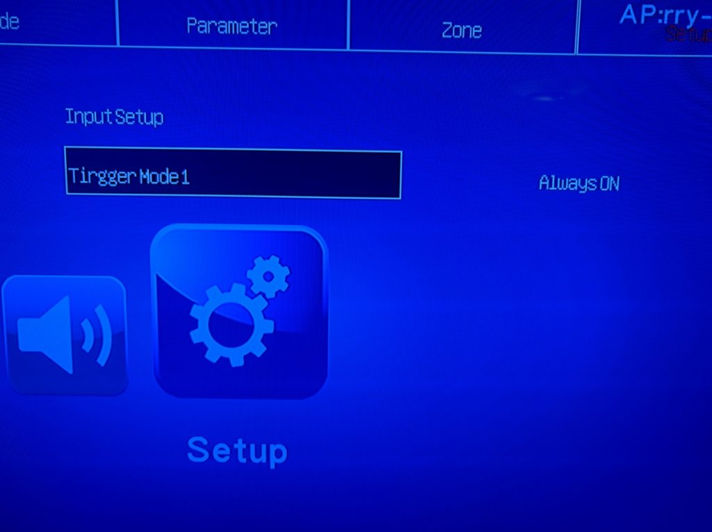

alexreusch
  • Posts: 74
Re: HD-AVP and MCH-K38 combo
« Reply #28 on: 20 Jan 2016, 06:00 pm »
Hi John,
This are my trigger settings. There is no "ON" option. Just in the Setup under Input it states "Tirgger Mode1" (wrong spelling) and I set this to AlwaysON
I have attached a photo from my setting.
Also, you find a photo of the trigger cable used. That's the one that was in the box. The problem is, that there is no packing list, what should be included in the box. The manual also says, that a test mic for Room Equalization is in the package, but I did not find any.

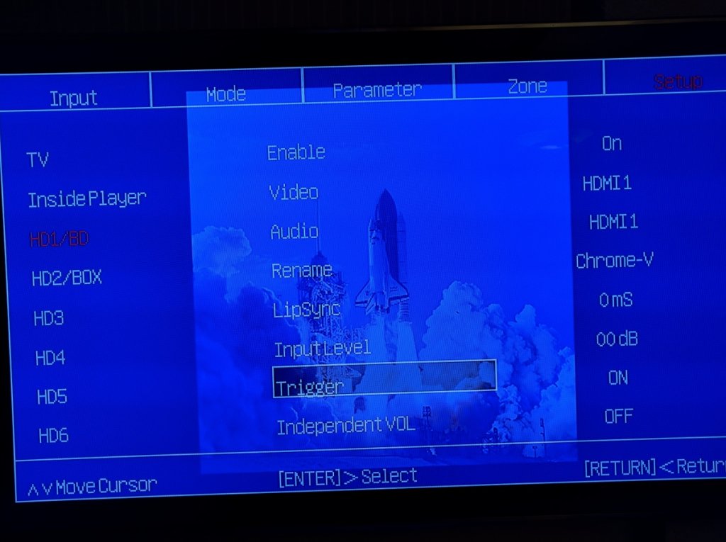

alexreusch
  • Posts: 74
« Reply #29 on: 20 Jan 2016, 07:04 pm »
I found a Trigger ON option and I checked that it is set for all sources.
