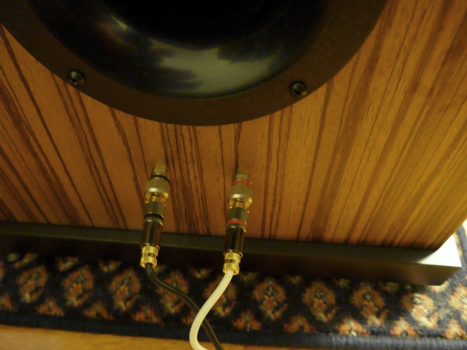

Rebbi, If you get a chance, I'd love to see the rear and new terminals Louis is using.  He says this month for me, so I'm trying to hold myself over till then!  :P

Here's a couple of shots.........   :thumb:

Here you go:
Sorry the orientation of the photos is screwy – don't know how to fix that!

« Reply #33 on: 3 Sep 2015, 05:06 am »
Thanks...  they're pretty alright.  Seems about the same as mine though.  Only mine are silver colored rather than gold.

I'd consider binding posts as well. Louis sells Supra posts which are a great value, Furutech posts are amazing but a lot of cash. I have Pomonas on mine and while they are very good the Supras are probably a better bet as they are more robust. Both are telurium copper afaik, which is a big step up from regular brass posts.
Peter, those BJC bananas are a big 'ol chunk of brass, I'd reconsider...

Pretty sure he's using Supra posts as the upgrade option:
https://www.madisoundspeakerstore.com/supra-binding-posts/supra-boxcon-binding-post-pair/
I don't think you can do better for the money, I believe they are tellurium copper which is ~99.5% copper vs brass at ~65-70%. The issue with brass is it causes grain and harshness, pure copper sounds far better. If you can use spades the Furutech FP-201 in gold or rhodium are the best value for high quality speaker connectors. The cheapest bananas I know of that are good are DH Labs locking bananas at $15 ea, Neotech has the same ones (thick style only) in rhodium for $25 ea. If you want really good bananas check out Furutech FT-212.
Also...
-the conductivity of platings is less than copper but they are so thin they have very little effect on the total resistance. Their largest effect is the effect they have on the signal as it passes through the plating material and material boundaries. Copper needs to be plated to avoid corrosion. Often people misunderstand electricity as flowing like water, and think things like platings are bottlenecks but it doesn't work like that. Fuses are a good example, they are made of super-thin wire but that doesn't mean your whole house can be wired with wire that thin. Also, resistance is linearly additive.
-the difference between solderless (set screw) and soldered connections is minimal, in fact the best RCA plug available, the WBT 0102 at $408/set, use soldered terminations and 0102s are probably used on 75% of cost-no-object cables.
-there is no issue with combining plated connections that use different plating materials. Maybe some people think there will be electrolysis but I have never seen any evidence of it and it does not negatively impact sound quality. In fact it's not a bad idea because combining platings minimizes the sonic contribution of any one plating material.
On forums, I've often heard people defend positions based entirely on faith and stubbornness. It's the internet and anyone can post. If you have specific questions about that stuff feel free to post a thread in my forum.
