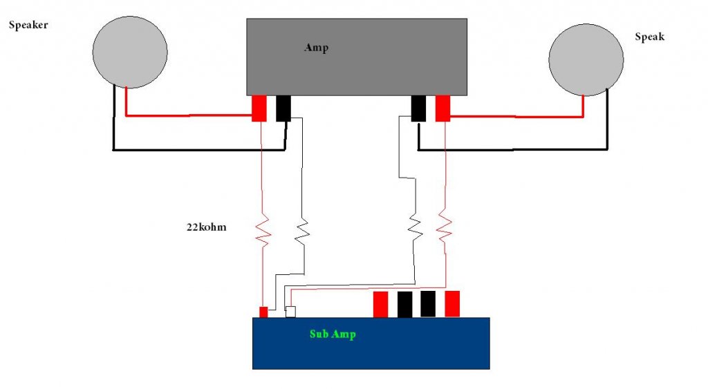

Folsom
Re: Do I need a buffer?
« Reply #31 on: 12 Aug 2015, 01:43 am »
Let me know if you have any questions. I did this, found it somewhere... Probably a flaw, maybe different values or whatever, but it worked great. Also twist your wires. This is just a diagram. You can also measure the voltage on them before plugging them in while playing music. If you see over 4v besides maybe a peak, you need more resistance. 2V should be fine at the gain for XLR and hopefully 1/4in, but for the RCA I'd hope to see a bit more, even double. These are all rough, you'll clearly know when you plug it in.
Great! I'll give this a try.
Thanks for your time.

Ed Schilling was the guy who came up with resistor loading to mate the Crowns that way. You can check the values on either his website Hornshoppe, or Bruce Rozenblits Transcendent Sound in the DIY section. Unfortunately, Ed is banned here so he can't directly reply.
steve
Folsom
« Reply #34 on: 12 Aug 2015, 03:11 am »
steve
He didn't invent it. I assure you, I did this before Crown XLS existed. I got it from someone else. It's not rocket science... or beyond electronics 101.
