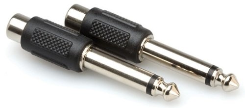

It's not the impedance. The Crown's input volume for the RCA's is really low. A buffer alone won't raise it unless it has gain.
Maybe the 1/4in has more gain? I'm not sure if anyone's tried. I bet you can try an RCA adapter to 1/4in cheaply before buying something with gain. Alternatively maybe transformers for single to balanced, then into the XLR.
Thanks for that. I'll order order a couple of those and hope that that's an easy and cheap solution.

Oh, you have to order? Darn, I thought they might be locally available!
