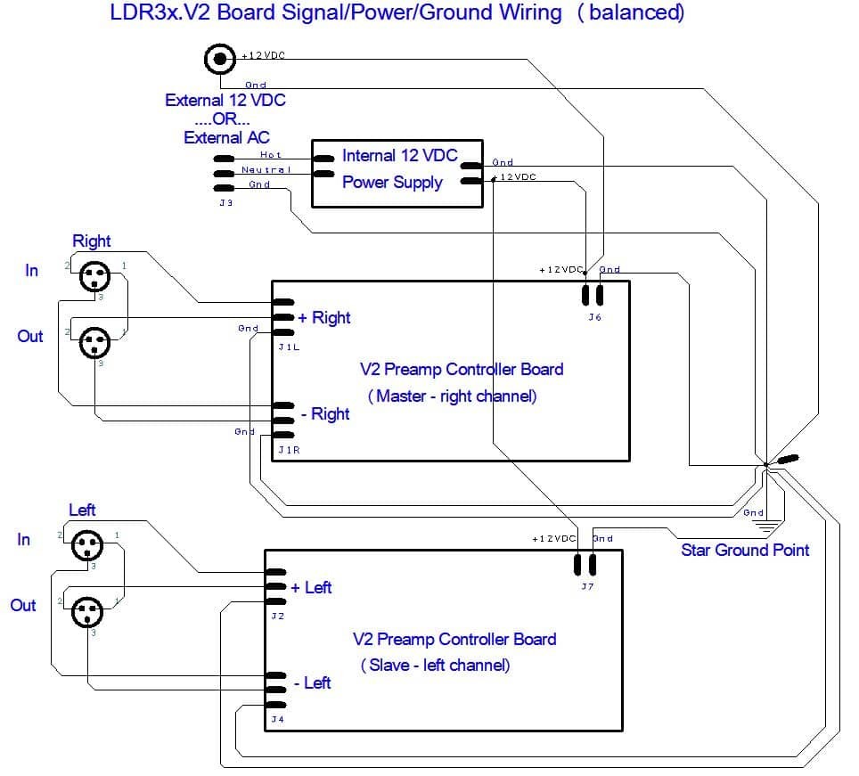

After a bit of struggle we finally solved a hum problem that only a few of our balanced preamp customers were having with our LDRxB models so we wrote up a brief article on the subject of the dreaded "pin 1 problem". Enjoy!
http://www.tortugaaudio.com/humming-along-to-the-pin-1-problem/

It sounds like that was not actually a pin 1 problem, but a missing ground...?
BTW you have a typo - "but connecting pin 1 the right avoids hum"
tortugaranger
  • Posts: 1779
    • Tortuga Audio
Re: Humming Along To The Pin 1 Problem
« Reply #2 on: 19 Jul 2015, 03:50 pm »
Thanks for the heads up on the typo. It's not clear to me why some balanced amps hum simply by connecting to a preamp without a grounded pin 1. What is clear is that shouldn't happen if the amp is designed properly. I completely accept that we could have avoided any hum problems by grounding pin from the beginning but then we wouldn't have anything to write about.  :duh:

tortugaranger
  • Posts: 1779
    • Tortuga Audio
« Reply #14 on: 29 Jul 2015, 08:07 pm »
I generally agree with the last few posts which are mostly saying the same thing with minor variations. In my view the absolute best approach is a fanatical adherence to using a single star ground point. The star ground point can be the chassis itself for an all metal enclosure but I actually prefer a isolated star ground point - an isolated bus bar if you like. Everything goes to the star ground point, including the chassis. And in the case of the pin 1's, they should also go to the star ground point although that's not shown in this graphic. This way there are no ground currents running through chassis or anything else except on its way to star ground and thus everything sees only a single ground potential. The star ground point has one connection back to earth ground via the incoming AC mains if present or the DC supply negative/ground. I've yet to run into any grounding issues by following this approach. When I do run into hum (on things I design/build)  I've always been able to trace it back to failure to star ground everything.
Speedskater
  • Posts: 2756
  • Kevin
« Reply #15 on: 29 Jul 2015, 08:42 pm »
I definitely agree with you "Star Ground Point" system.
The small changes that I would make:
1] Move the "Star Ground Point" chassis connection to near the input connectors (it may already be that way).
2] Remove the AC Safety Ground from the "Star Ground Point". Connect it to the chassis near AC J3.
3] Remove all the XLR Pin #1 jumpers and connect each one to the chassis at the XLR connector.
tortugaranger
  • Posts: 1779
    • Tortuga Audio
« Reply #16 on: 30 Jul 2015, 01:53 pm »
1) I'm ok with this but in my view that's really a nit.
2) This moves away from a star ground centric approach and invites the possibility of the star ground being at a different potential than the chassis. I realize the "earth to chassis" has been a traditional approach. I just don't agree with it. In my view "earth to star" and "chassis to star" (everything to star) preserves both the integrity of the star philosophy while also being safe.
3) Not sure what this accomplishes. Everything to star all the time - no hum.
