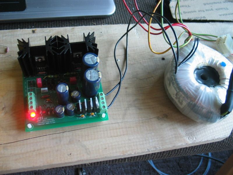

Just built this Sigma11 LPS 12v 3 amp with a Switchcraft 2.1mm plug and works fine on new 2Qute.
