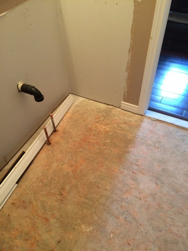

6 weeks ago a toilet in the main bath on the 2nd floor busted.  I arrived home from work to hear water running on the main floor, and 1 inch of water in the upstairs bathroom on the floor.
Insurance claim.  Excellent service from the water restoration company to demo most of the upstairs bathroom, and around 100 square feet of ceiling in the living room, and roughly 10 feet of the interior wall on the outside wall.  7 very long days and nights of large dehumidifiers and fans running.  Saved the hardwood in the living/dining room.
There was no damage to any of the past work done (kitchen, main floor fireplace, basement etc).  That's a big relief.

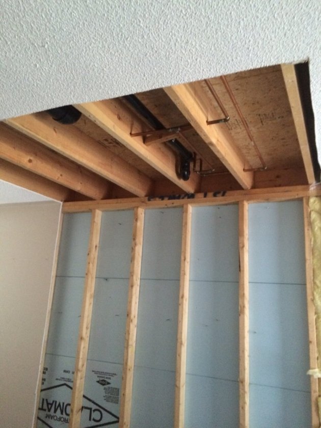

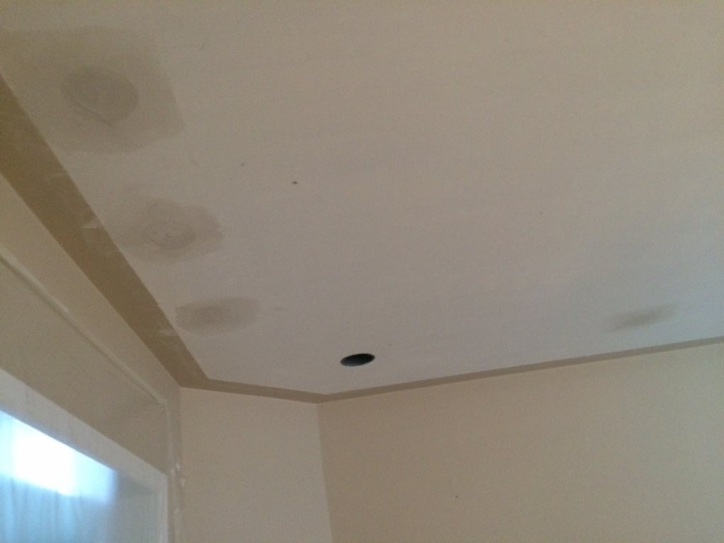

« Reply #7 on: 19 Jul 2015, 07:22 pm »

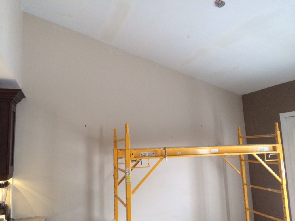

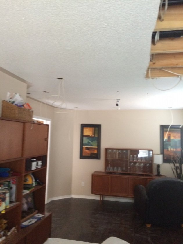

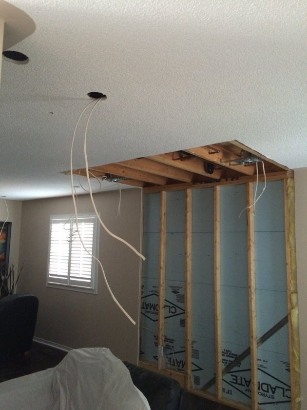

Electrical is done (other than installing trim for the pot lights, but that comes after the ceilings repairs are done, and the painting is done etc).
All the popcorn scraped off the entire main floor.  Most of the mudding and taping is done too.
Paint and crown to be done early August.
Longer timeline that I would like, but quality takes time!
Some pics below of the progress.

I am always amazed that drywall work that looks like crap looks great then the mudding is done. I used to do this for several months years ago!

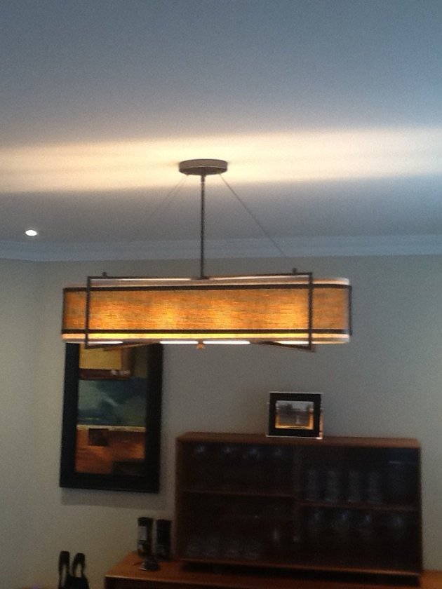

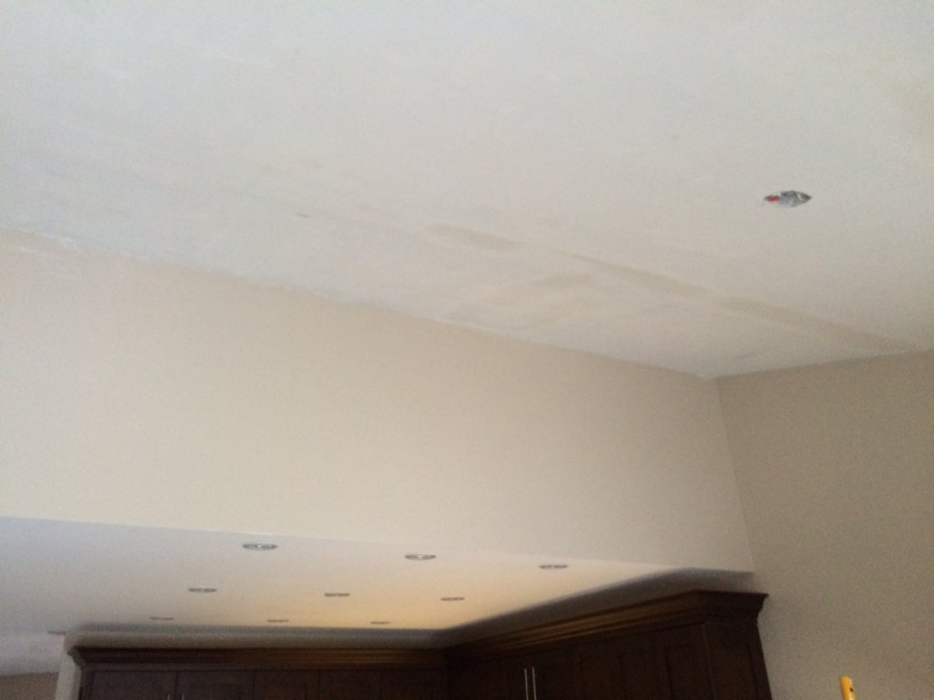

Had a good experience on the main floor.   Happy with how it turned out.
Always amazing to see guys who mud and tape and know what they are doing.  They fly and it looks great.
Added a new dining room fixture.  Wanted something to go with our mid century modern teak set but not be too modern.   You can see one of the pot lights and some of the crown moulding too.
