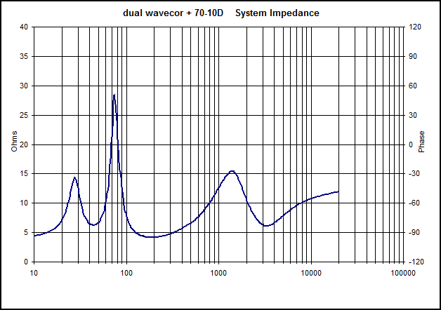

Thought I'd post up a recent data set of what happens to the response of a speaker when a low impedance solid state amp drives it compared to a low feedback tube amp.
Here we see a Clayton 300W monoblock compared to a 300B SET on the same speaker.  The Clayton is in blue, the 300B in red.  The largest and most audible difference can be seen where the impedance of the speaker drops to the 4 Ohm range.  There is a very noticeable drop in output from the 300B in that range which will be heard as a thinning of the sound, with vocals loosing a bit of "body."
This altering of the frequency response can be alleviated with some impedance conjugate filtering applied to speaker to make the impedance a much flatter line across the band.  Most speakers do not do such things and will show similar swings in their impedance.
This is why negative feedback is a very useful feature in amplifiers as it greatly reduces the amplifier's susceptibility to variances in speaker impedance.  It can also explain why some refer to system "synergy" between speakers and tube amps and is something to really pay attention to when choosing your final setup.

There's enough info in the graphs to draw some conclusions and it's based on the fact that the speaker does not present a constant impedance.  Because of that fact, these two amps produce quite different response plots using the same speaker as their load.  This wasn't posted to show that one amp is better than the other or to slam the obviously lower feedback SET compared to the SS amp.  Only that these things need to be taken into account when listening to speakers with different amps/topologies so that one can identify the sources for differences in sound which in this case would be an obvious change in response.
